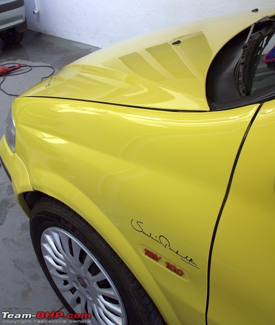

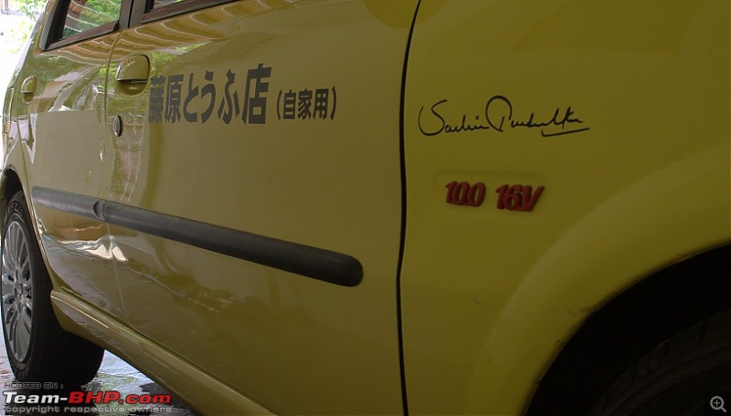

Broke out my old favourite, Meguiar's M26 Hi Tech Yellow Wax. Its the only wax that I'm aware of that can be applied with a rotary, and that is how I intend to apply
After 2 coats:

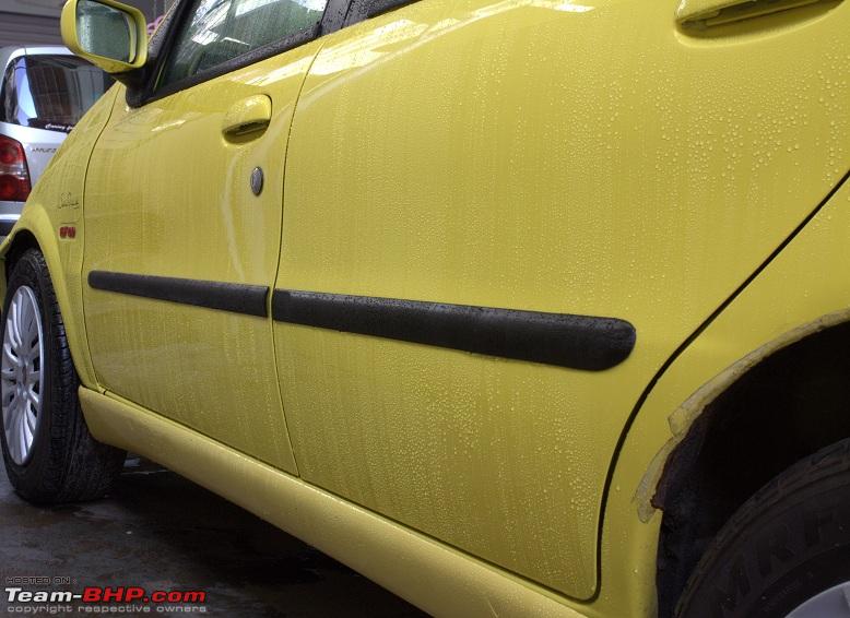

Beading from M26 first coat, cleaning with water before I put on the second coat:

Excellent finish SunnyBoi. That beading says it all. The shine makes it hard to gauge the age of the car. How old ?
M26 is pure wax. Would you try any sealant along with it ?
Since Opti coat 2.0 is like a permanent coat, I assume it went before the wax, right ?
Did you apply anything to the tyres ?

The car is a dozen year old but all the panels have been repainted at sometime in the past.
I'm not at all concerned with longetivity hence not using a sealant.
ONly the hood and hatch on my car have opticoat since the paint is now wafer thin. Opticoat was applied over a month back and now topped it with M26 wax
Tyres were dressed with Meguiars Hyper Dressing 3 weeks back.

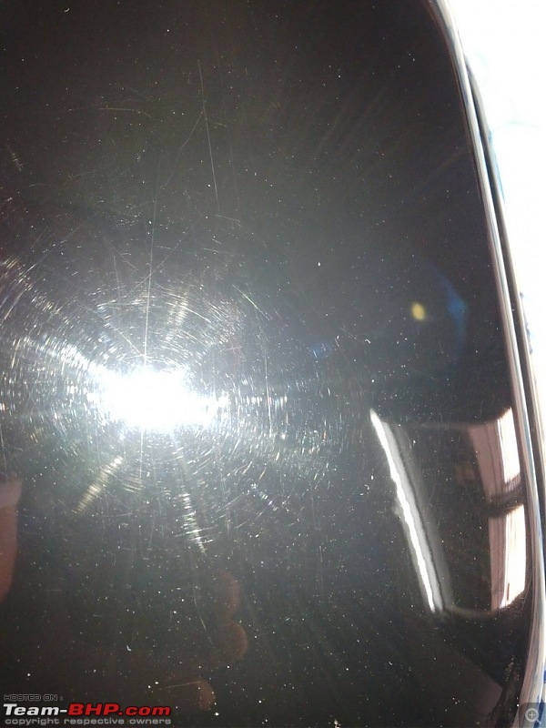

In the morning applied another coat of UPGP and realised that it streaked after drying. Rushed to wipe it off with a MF (which I presume is wrong), but the surface is still smooth to feel and has got some added shine.
However, there are now swirls visible, when held into the sunlight, which were not visible before. So now, will be polishing it with Autoglym SRP next week, then sealing it with UPGP. Have used Autoglym SRP on my car though and have some queries on the same, which are put up in the All About Car Polishing thread. Posting some pictures of the battery panel before and after using UPGP.

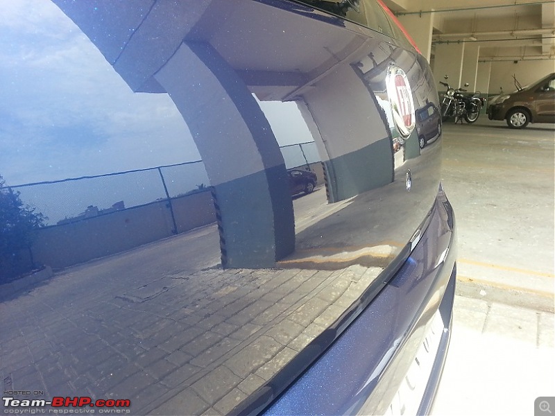

Decided to revive the paintwork on the boot today. Products used:
Scholl Concepts S20B Polish - This is a diminishing abrasive polish capable of removing 2500 grit sanding marks and yet finishes LSP ready on most paints. It did correct the wash marring, some Random scratches and finished very well.
S 20B http://www.schollconcepts.eu/en/news...ounds/s20-blue
Lake Country Hydro Tech Tangerine polishing pad - A closed cell polishing pad in low profile specifically for the rotary. They have the same pads in high profile for a DA.
LC HT Pads http://www.i4detailing.co.uk/shop/la...ml#aH20_2d2255
Sonax Xtreme Protect & Shine Sealant - This is the retail version of their Sonax Profiline Polymer Netshield. This is designed for the DIY user and does not flash immediately, leaving you enough time to apply and buff slowly to an insane gloss. I have the Polymet Netshield on most of the car so wanted to try P&S again. It won the sealant of the year award on DetailingWorld UK this year and rightfully so. It is very easy to apply, produces an insane amount of gloss, beads are very tight indeed. It also has significant anti-static effect that helps me a lot to keep the car cleaner, for longer. Unless it rains, all I need is a Jopasu and the car is always good as just detailed. No need for even a QD or WW and I have been washing the car once every fortnight.
DW Products of the year list http://www.detailingworld.co.uk/foru...d.php?t=332951
Sonax Xtreme P&S http://www.cleanyourcar.co.uk/sealan...prod_1200.html
Disclaimer: I am not associated with any of these brands or sellers.

Sonax Xtreme Protect & Shine Sealant - It is very easy to apply, produces an insane amount of gloss, beads are very tight indeed. It also has significant anti-static effect that helps me a lot to keep the car cleaner, for longer. Unless it rains, all I need is a Jopasu and the car is always good as just detailed. No need for even a QD or WW and I have been washing the car once every fortnight.
The car looks stunning, With Maintenance like that it gets difficult to judge the products, but man i was blown away by the video you shared. Will definitely try P&S. Such products are a must for indian weather conditions.
