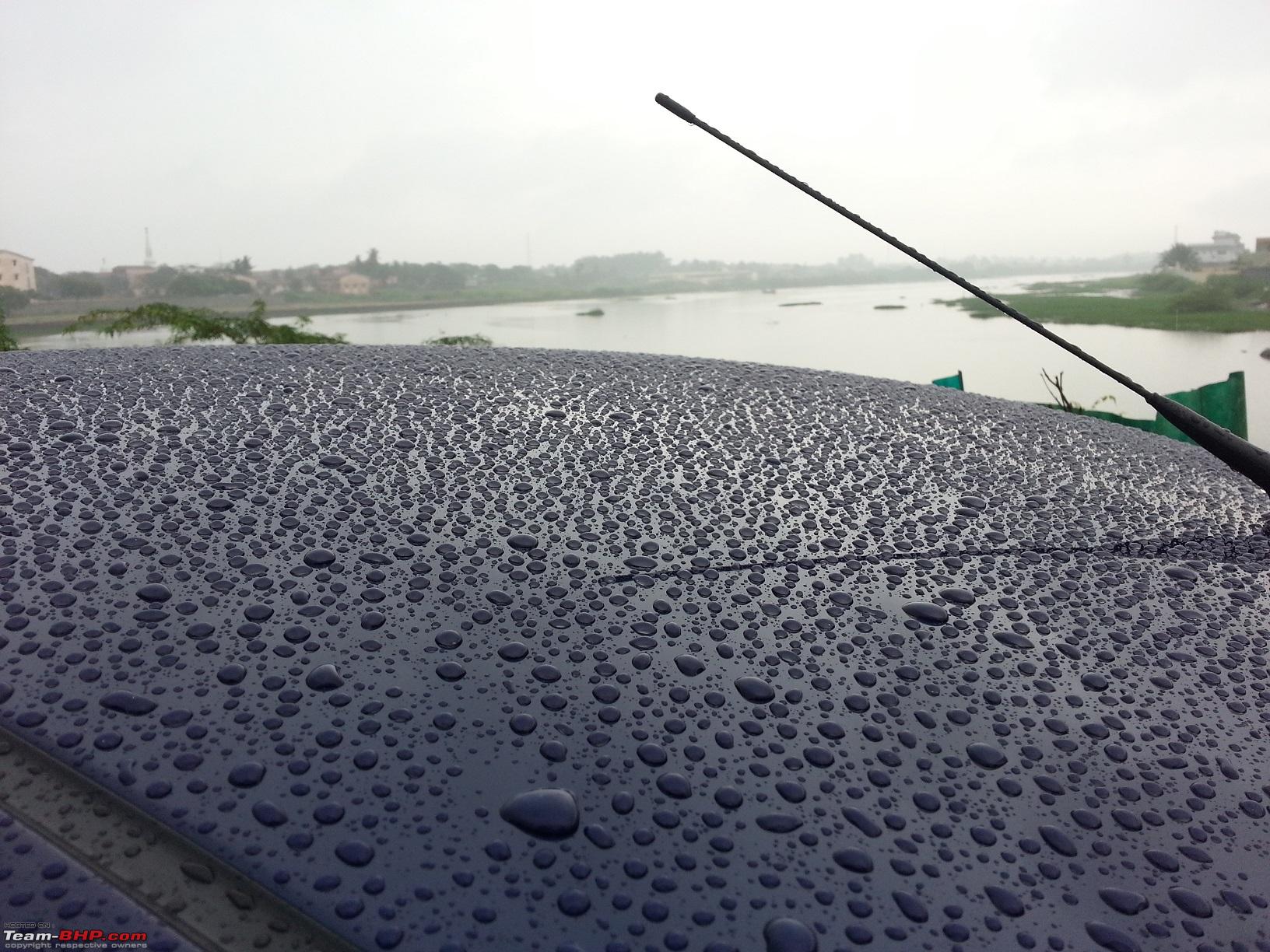

Beading Shots
Beading shots in the rain.
That is v good wax effect. Please share your thoughts the work to be done once you are thro' such rain, just
wipe with a MF towel or let the droplets roll off? Tnx n cheers
