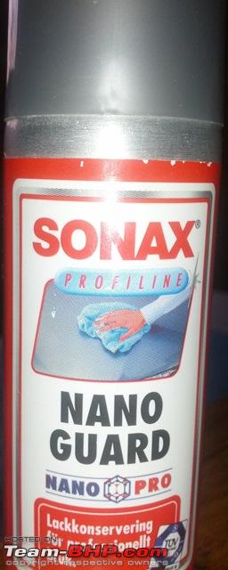

Hi guys, my friends recommended this for our silky gold fortuner. Does any one know about it or give some comments? A sample bottle will be with us next week.

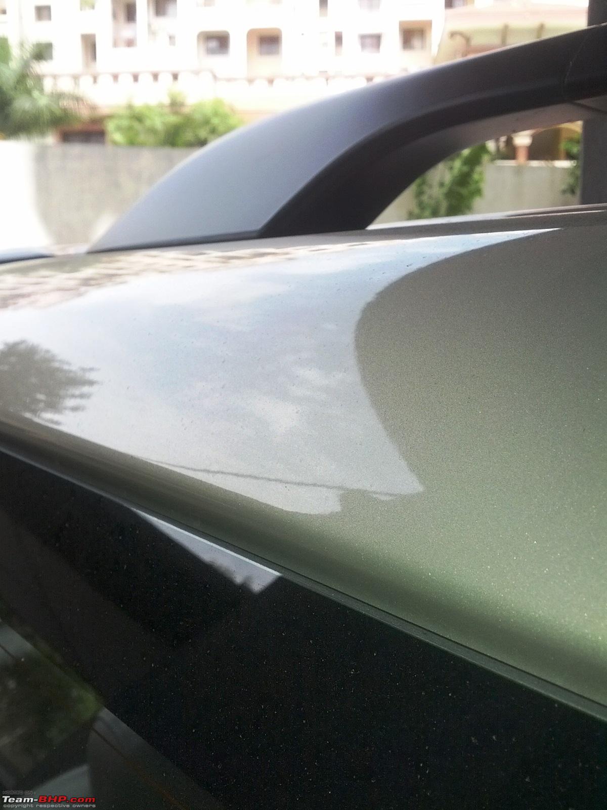

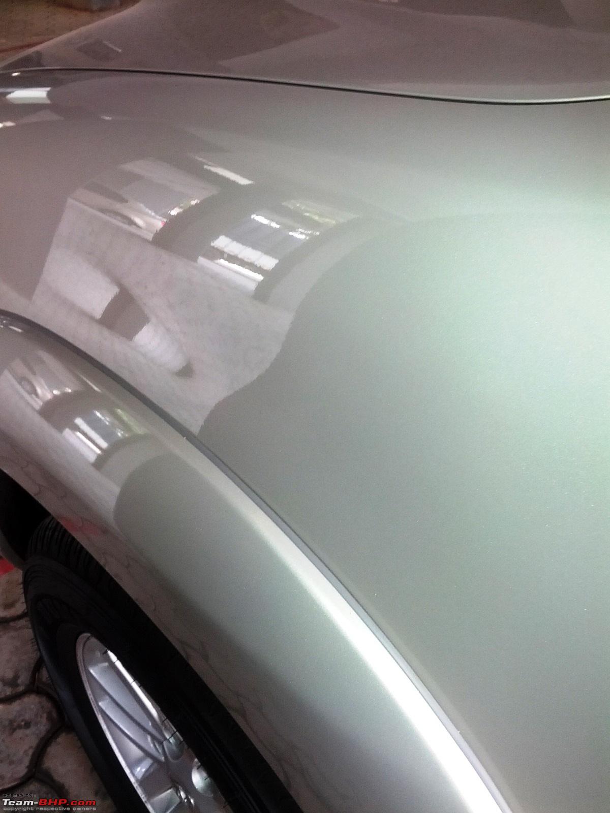

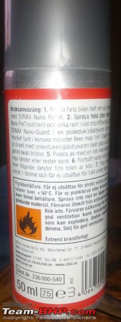

Its 6 months and 5000 kms of rough use and wash/wipe once in 2 weeks after i applied the Sonax Nano Guard Paint Protection and i admit this nifty little 50ml pocket rocket costed approx Euro30 but well worth it. (Bought in Europe)
So whats the noise about ? Click to see for yourself.
http://professional.sonax.com/Vehicl...-Paint-protect
Pay attention to the reflection of the untreated bumper vs treated paint surface.) The surface when felt with hand isnt silky waxed smooth but little rough, but that's how it is.We wash the car myself and it was washed last week with clinic plus shampoo.
Now let see the pictures and a video of water effect below. Since the car isnt washed, you can see the dust on it still.

So the vehicle has NO polish/wax or whatever. The bumpers are untouched by this treatment.
Now Euro30 protection for approx 8-9 months clap: heck why not. I will apply one layer more in December.
After covering the entire vehicle, i think there is close to 10-15 ml left in the can.

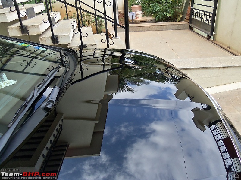

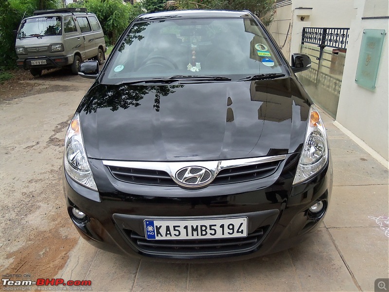

I recently got the opportunity to use Sonax Gloss Shampoo (SGS) and Sonax High Speed Wax (SHSW). Since this is a thread dedicated to Waxes and Sealants I will focus on the SHSW.
Details:
1.- Packaging: Plastic bottle with spray nozzle
2.- Directions: Simple and clear
3.- Viscosity: Thin liquid
4.- Color: White
5.- Scent: None
6.- MRP: Rs.749 for 500ml
8.- Manufacturer: Sonax GmbH
9.- Made in: Germany
10. Availability: Shell petrol bunks and few auto accessory shops including Torque Bhimanagar and MotoAdda Indiranagar. It is available on Snapdeal as well but does not ship to my address.
I bought it from Torque in Bhimanagar for Rs710.
Prepped the car with a SGS wash and soaked up most of the water with a Sonax Xtreme MF towel. Sprayed the SHSW onto the slightly wet panel and spread it with an MF cloth. The liquid wax dries and hazes quickly. Buffed the surface immediately using a second MF cloth while applying light to nil pressure.
I tackled one panel at a time and used sparing quantities of the stuff - about 2 sprays on a bonnet (A-Star). Applying larger quantities will leave behind some wax swirls which can be seen from certain angles. I found out the hard way that less is better.
The nozzle provides a very fine spray. This is great for the first few panels, however the spray gets blown onto waxed surfaces if the wind is up. Overspray eventually leads to white spots. I missed a spot on the roof and confidently sprayed the wax only to see it spread across the windshield and bonnet as well. Towards the end of the session I found myself spraying onto the MF towel and applying it onto the surface instead.
Waxing the car took about 20 mins for a coat. Since this was my first wax/detailing session (its my first car you see:)), I applied two coats for better protection and coverage in case I missed a few spots and was generous with the time spent.
I wanted a glossy shine and hence was initially hesitant to use this product. I am happy with the results though. It does not correct any swirls or remove any contaminants. It does not correct any scratches either. What is does do is leave a rich smooth look and has made dusting the car with the Jopasu easier. The gloss seen in the pics is the handiwork of SGS. Two weeks, two water washes and two rains later, the wax still does a good job of beading the water (see beading images).
I have been through many pages of this thread. I am a complete noob too. I still can't quite grasp the different things that can be done. A search for care care products in Snapdeal also didn't help me. Just added to my confusion. :Frustrati
There is a beautiful detailed black Verna a few pages back. I don't think I can achieve that kind of a result in my first go nor do I want to spend that much just to see if I can detail my car myself.
Your post is very helpful. This is exactly what I had in mind. To use some not too expensive products and try it out.
You seem quite pleased with the outcome. I am more than willing to give it a try.
I think I'l' go in for the same products as you did. Basically I would need:
1. Sonex Gloss Shampoo
2. Sonex High Speed Wax
3. 3 Japasu MF towels
Am I missing anything? How is SGS to be used? and what does one use to apply the wax ?

Last sundays effort with Sonax :)
My car has been wearing various Sonax products - Sealants, wax and their coating for over 4 months. Almost each panel had a different Sonax product on it. The Carnuba hunger had been building up over the last 4 months and this weekend I decided to do a complete detail on my car. Since it's been raining here for over a month and I have been very busy at work as well as home, the car has been getting a foam wash at a local car wash that has been building up a significant amount of wash marring, micro scratches all over. Hence, I had to machine polish the entire car. Process followed:I noticed the unbuffed wax on some panels after taking the pictures. The recommended waiting time before buffing off this wax is about 45 second but in our weather it worked better with 30 seconds. Swipe test helps.
It was almost 3 months since I had applied Four Star Ultimate Paint Protection and the beading property had reduced. So decided to prepare the car for monsoon. First applied Poorboys Black hole and then applied two coats of Fourstar Ultimate Paint Protection with 6 hours of gap in between. Allowed it to cure for 12 hours in the night and then applied Poorboys Natty Blue Paste wax this morning.
I also got Sonax High Speed Wax from the same shop last week. I am impressed with the gloss and shine. It is also value for money at Rs. 700. I could not test the beading as car has not seen a proper rain after that.
Hope it will last for a couple of months at least.
Few panels had Collinite 845, applied a couple of months back. I just topped it with Sonax High Speed Wax. I also noticed that the plastic parts (light panels, plastic stips) gives a good gloss with the product.
On rest of the panels, I applied Duragloss 101 (polish and cleaner), followed by Sonax High Speed Wax.
