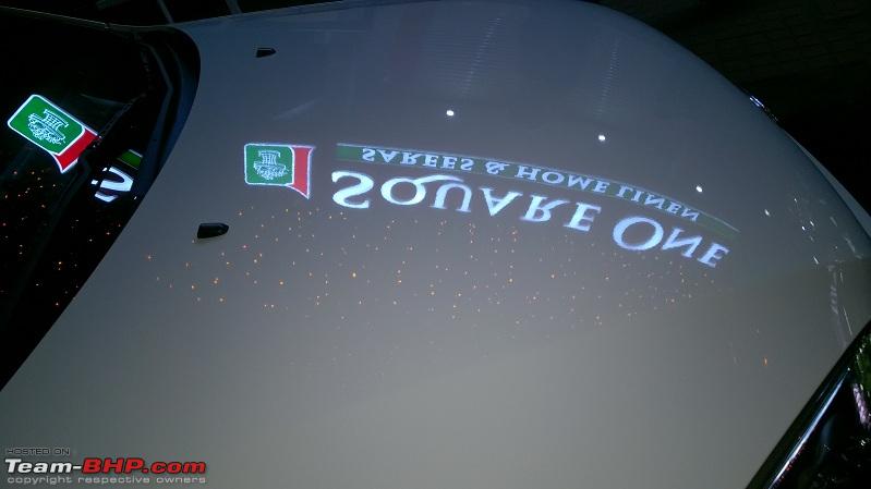

Tried to click some pics of the minor swirls but as I said earlier, they're hardly noticeable and I think no swirl correction is needed for the time being.
Posting some pics of the ride :
So as the polishing step is set aside, IPA must be used for stripping down the wax right? Or will using the Elastrofoam block take care of it?
EDIT : Has anyone here used dishwash soap to strip off the existing wax? Is it safe?
Don't get confused so much.
Claying will remove the existing wax. Elastrofoam will remove the existing wax so do not worry about it much.
