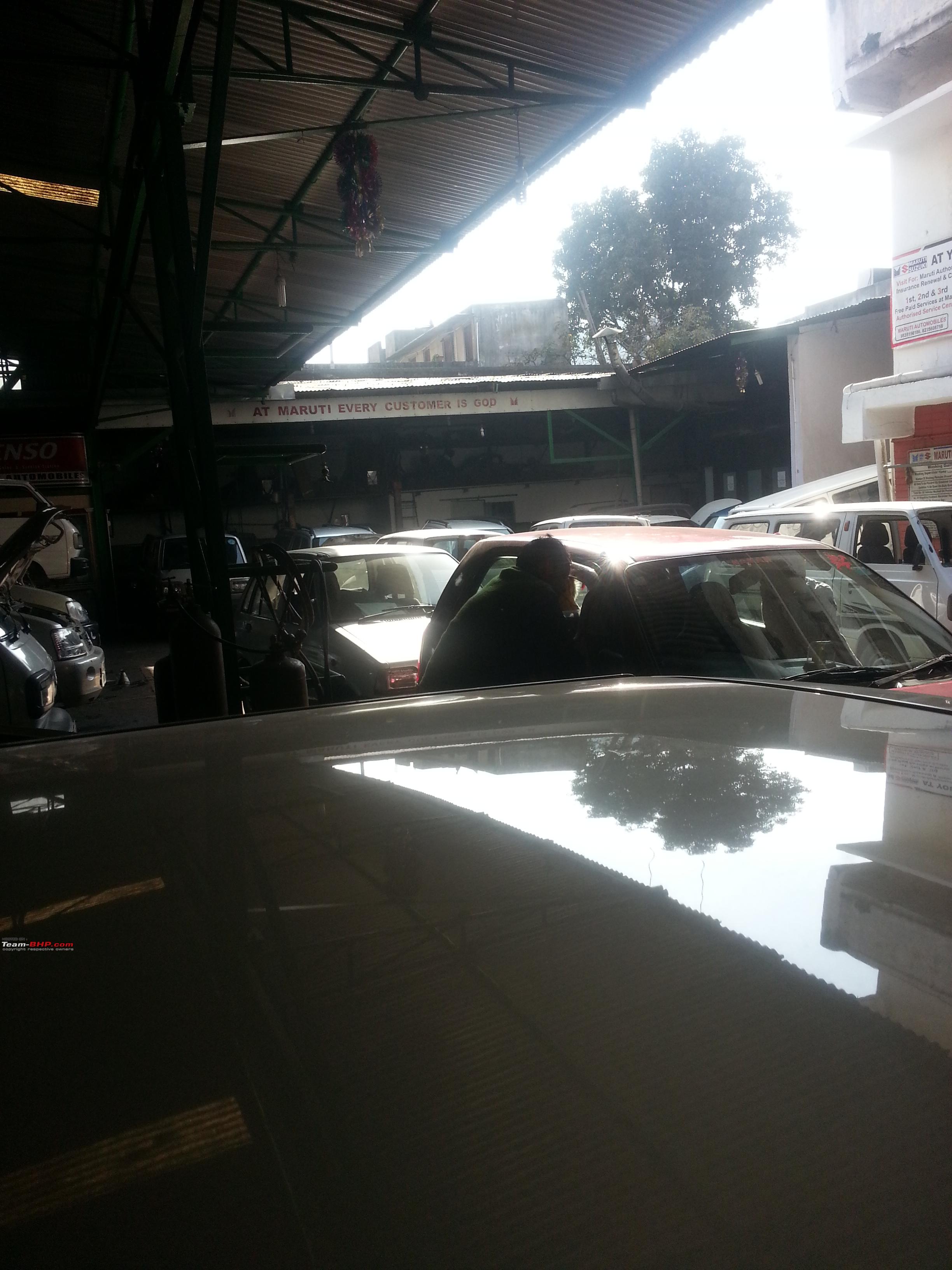

Not to rub it, but just to make TATA understand how a customer should be treated, here's a pic of a MASS- I request everyone reading my post to kindly zoom it and have a look
