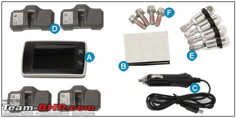

What's in the box (new model)
A) 1 receiver/display unit
B) 2 velcro adhesive strips for affixing the receiver/display unit on the dashboard.
C) 12 V adapter that plugs into the 12 V socket, and the other end plugs into the receiver / display unit.
D) 1 sensor for each corner x 4.
E) 4 aluminium valves with caps
F) 4 nylok screws
^^^Picture courtesy: TyreProbe

Originally Posted by joybhowmik View Post
Which one to buy?
I like to invest time before investing money in any product I buy. Researching with websites, asking friends are all par for the course. This time was no different.
Direct TPMS retails on ebay for approximately Rs 10,000/-. Bridgestone Select stores retail a TPMS and GPS package for approximately Rs 13,000/-
I also came across the product I eventually bought: TyreProbe
(More on pricing later)
I am not aware if there is any other mainstream channel available for buying aftermarket TPMS in India
Do you remember the brand being sold at the Bridgestone Stores?
Incidentally, M&M use a Schrader TPMS system for their vehicles (Scorpio / XUV500 / e2o etc.) - seems to be pretty robust, from what I can see after over 4.5 years of use. Was this brand available when you researched before buying your TPMS system?
SS-Traveller is offline   (1) Thanks
Old 22nd April 2014, 14:48   #4
joybhowmik's Avatar
Join Date: Aug 2005
Posts: 1,421
Thanked: 2,281 Times
re: TyreProbe TPMS - 6 month review
Thanks for sharing such a lot of detail about your experiences with the Tyreprobe TPMS. Apparently, either it isn't that rugged, or the dealer installing it isn't doing a good job. Too many incidents of failure in a short time.
I think it is a combination. The first time the unit failed (old model), one can pass the failure as a poor product design. Apparently the manufacturer had received market feedback and had improved the product (aluminum valves et al).
The second time (FL sensor) plus third time(FR sensor) that the new product failed, was in all likelihood a dealer issue. He had not bothered to install the aluminum valves that had shipped with the new model. Instead the old model's rubber valves were fastened to the sensor using the old steel screw. Now after the screw caught rust, it was a matter of time before it just disintegrated leaving the sensor free inside the tyre. In next to no time, the battery went dead, and the sensor was useless. Now that the third unit has been installed at the Tyre Emporium (not a dealer of Triton) and under my watchful eye - I think I can safely remove the dealer variable from any subsequent product failure. Though am keeping my fingers crossed.
IIRC, it was Bridgestone branded or co-branded - can't recall the name of the manufacturer.
Incidentally, M&M use a Schrader TPMS system .... Was this brand available when you researched before buying your TPMS system?
No. I did not come across this name. Maybe, they sell only as OEM to M&M.
There's not enough secondary demand yet in India that, retailers /e-tailers will stock world-class products such as Schrader. Most car-accessory shops in Delhi dont even have a catalog of TPMS to show the customer. e-tailers at ebay sell unbranded or relatively unknown brands. Triton seems to be the only indigenous seller in the market -but like I said still a long way to go before they can vertically integrate from manufacturing to distribution - like they do with their core products. I think that once they start making the parts themselves, the qc will be much better as there will be more internal accountability.
