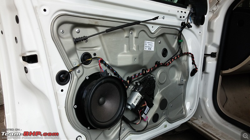

Body Repair: How to remove & reinstall Rivets?-front_door3.jpg
This is some intermediate metal sheet that's riveted. You can see the speaker is also riveted. They were going to cut the rivets using a chisel and a hammer when I stopped them.

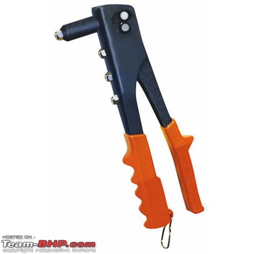

It's a very easy technique, don't know about India, but in any toolshop in Europe you can buy a poprivet tool for just a few Euro's.
I was gifted one of these, but not sure where it was purchased from - though I'm sure they are available here too.
Body Repair: How to remove & reinstall Rivets?-poprivetgun.jpg
@anandpadhye - naturally the industrial versions will be different, in order to auto-load and not require manual force to operate.

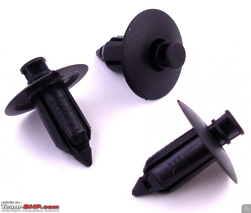

Originally Posted by Jeroen (Post 3458194)
On cars, espcially you might also find plastic rivets. Essentially the very same principle, the rivets even look the same, with a similar tool to place them. Often used on upholsterday and bits of pieces on the dash, panels etc.
Some of the bigger ones even have the advantage of being re-usable. If you push in the center portion, the 'rivet' detaches itself. The center portion then pops out again for re-attachment.
Something like this:
R
Great picture of the tool, I've got one just like that.
Great picture of the plastic "rivets". I have them everywhere in several of my cars. They tend to be a lot bigger than the metal/aluminiu, rivets. They're often used to hold upholstery/panels in place in cars.

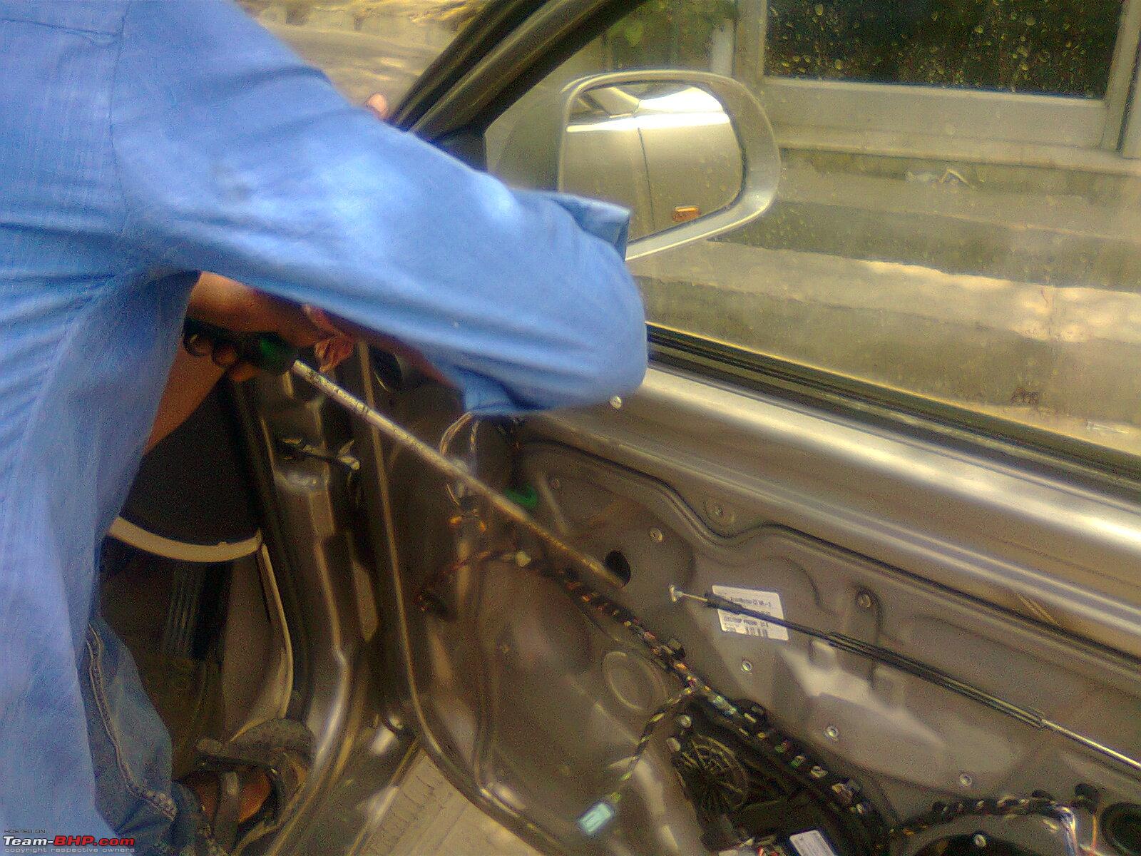

Dear Anand, I happened to come across a Laura which was being repaired for a dent on the front right door and it's lower part. The technician told it is really tough to remove the rivets but there is always a way out. Here are some pics that may help you.
Wow. Thank you so much. This really helps. I am looking at my picture and yours and see that it's exactly the same (of course, it's the same car, but they have also opened the door trim and the internals also look the same). I see they did not even attempt to remove the rivets, instead they seem to have clipped off two of the plastic caps to gain access to the outer door metal and they inserted screw driver to hammer out the dent! Interesting. I guess the effectiveness will depend on the position and size of the dent. In my case, the guy was sure that he needs to remove the speaker to gain access. But now I will take a closer look at those black plastic caps. Thanks again.

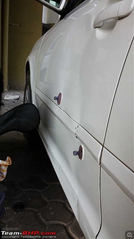

The overall dent:
Body Repair: How to remove & reinstall Rivets?-img20140619wa0002.jpg
A closer look at the dent:
Body Repair: How to remove & reinstall Rivets?-cam00090.jpg
Removing the black marks using some cream:
Body Repair: How to remove & reinstall Rivets?-cam00092.jpg
Body Repair: How to remove & reinstall Rivets?-cam00094.jpg
Starting to pull the dent:
Body Repair: How to remove & reinstall Rivets?-cam00099.jpg
The result:
Body Repair: How to remove & reinstall Rivets?-cam00105.jpg
Body Repair: How to remove & reinstall Rivets?-cam00108.jpg
He requested me not to take pictures when he actually pulled the dents out as that's his USP, so I agreed.
Overall, he could remove 80% of the dent, the side strip posed a challenge, some areas around it could not be restored fully. Also, as per him, when the door received the hit, the metal hit some parts inside (like the glass winder) and hence a couple of small spots around the side-strip got dented from inside. He used a plastic hammer to even them out, but said that only spot welding will restore them fully. Final result is quite acceptable, original paint is intact, and it's no more an eyesore when you look at the car casually. A closer look surely reveals the uneven surface at places. But I can definitely live with this and take my own time to study this whole dent-painting ecosystem, find a competent and reasonable garage that believes in minimizing wastage, has the right tools and most importantly, calls rivets "rivets" and not "ribbits" :)
