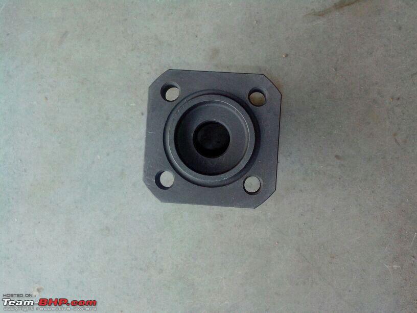

Just curious, how does a cranckshaft hub bolt affect performance as described?

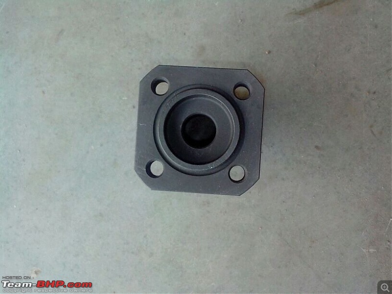

I have already got this part replaced( here is the image of the part that was replaced) and after that I have driven my car more than 15000 KMS but have not faced any problem, although I do not encourage driving at such speed but it is really bothering me as why my car is not going north of 120KMPH and what is that vibration?
