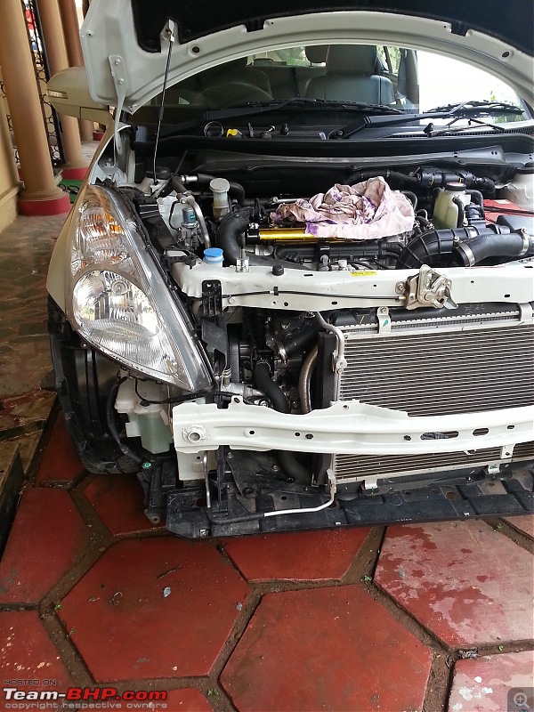

What we call as "Bumpers" car manufacturers abroad call them as "Bumper covers" because the real bumper is the metal beam with energy absorbing deformable foam/plastic pieces on it which sits behind the plastic bumper cover.
In INDIA that metal cross beam is present in all vehicles, but not all manufacturer provides the energy absorbing deformable plastic/foam pieces which goes behind the bumper cover and on the metal beam. Some manufactures do provide that on some models India.

Foreign Swift - With deformable energy absorbing pieces behind bumper (cover)
Foreign Swift - Another angle to show the thickness of the energy absorber
Have Manufacturers made bumpers useless?-7howtoremovethefrontfenderfromasuzukiswiftlookmanofender.jpg
Indian Swift - With NO energy absorbing piece behind bumper (cover)
PS: Images sourced through google images.
