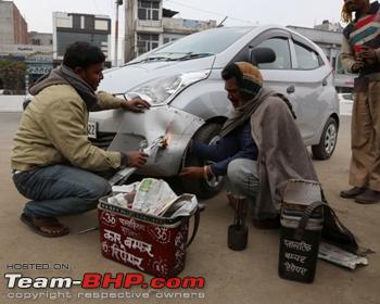

1) The first problem with FNGs is they dont have access to a paint booth. All their work is by the roadside. I have already enlisted the issues that this exposes the job to in an earlier post.

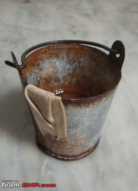

2) Washing:
The process of washing should be undertaken with a initial pre-spray followed by soaping down the entire body using micro-fibre cloth. This gets rid of surface contaminants without leaving any marks on the surface. This is finished with a finishing spray, to wash off the soapy residue.
What the FNG mechanic employs is a rag and hopefully clean water:
Source: Google images
All about car dent repair & painting - Processes, methods & tools-dirty-rag-water.jpg
3) Removal of badges and trim:
The process should be approached with genteel and using the appropriate tools that I have detailed in the article.
What the FNG mechanic employs is a screwdriver. He can end up scratching the trim as a result if it slips.
All about car dent repair & painting - Processes, methods & tools-screwdriver.jpg
4) Sanding the creased area to bare metal
The process requires that the creased/dented area be sanded back to bare metal.
Consceint FNG mechanics will do this - but will take a long time about it because they would use 50 # or 80 # paper. Normally they won't own an angle grinder.
Others won't even bother.
5) Using the right dent removal tools and methods
a) For panels that can be easily accessed, the process requires one to take the panel out, and then fix the dent using the hammer off and hammer on technique (described in an earlier post).
This ensures that absolutely the minimum amount of body filler is needed.
What FNG mechanics usually do is to fix the dent in-situ. They don't bother to take the panel out and fix it using above technique.
They also don't have a variety of hammers, dollies and spoons at their disposal. They make do with the generic peen hammers (shown in one of the earlier posts) , a regular file (which they use as a shrinking dolly) All about car dent repair & painting - Processes, methods & tools-file-tool.jpgand a screwdriver
Invariably this leaves behind ripples, dings, small creases in the job. To be filled up with body filler of course. Less than ideal.
b) For panels that cannot be easily accessed, e.g. running boards.
The proper method requires either using a spot weld/slide-hammer (for easy to remove dent) or cutting out the running board using an ox-acetylene torch, fixing the dent, and plug welding it back (for dents where the creases are just too much).
Here's where the FNG's ingenuity is striking.
i) Option 1: Often they will use a chisel and hammer to open the seam weld, and then use a screwdriver + file to push out the dented area.
ii) Option 2: In other cases, especially when the crease is too much to handle using this method, they will punch holes into the running board - a bit like swiss cheese, and then use a screwdriver or a pick like tool to pry out the dent. Something like this picture.

Bumper (Cover) Repair
Like it or not, in many accidents however minor they may be, the plastic bumper cover commonly mistakenly identified as the bumper is the first point of impact. In major impacts, the bumper cover and bumper absorbs the shock of impact, and thus needs to be replaced.
In minor incidents - such as a biker knocking up against the rear at a traffic signal, the worst damage can be a cover that's got a depression, and possibly a few locks/fasteners broken - with no damage to the paint.
Image courtesy: Shankyz
All about car dent repair & painting - Processes, methods & tools-dented-bumper.jpg
In such cases, the neighborhood bumper repair person is one's best bet. Again there are two kinds:
1) The nomadic type who carry the workshop on their cycle
All about car dent repair & painting - Processes, methods & tools-carbumper.jpg
2) The settler type , who actually have a shop in the local auto parts market.
All about car dent repair & painting - Processes, methods & tools-carbumper2.jpg
Both kinds charge a minimal amount of Rs 100/- to Rs 250/- to unfasten the bumper cover , pry out any dents using heat, fix minor tears , and even fixing broken snap on locks/fasteners with new plastic.
But remember this is only when the bumper cover has suffered minor damage. For major damage - e.g. major perforations or tears, get the bumper cover replaced.
