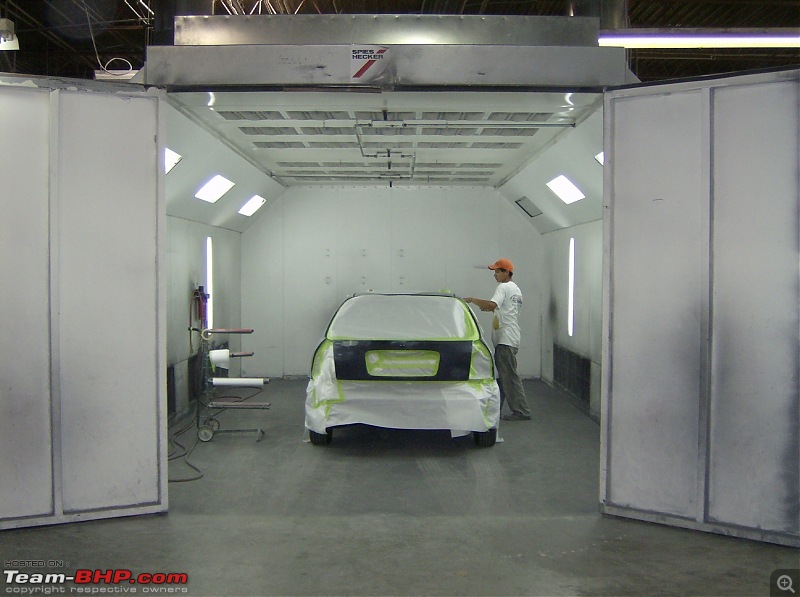

Paint process outside the factory (continued)
If you are in a paint booth, nothing could be better. A paint booth helps because it has facilities to abstract the harmful fumes out of the way, ensure that no contaminants enter the area, and provide an even temperature environment to help cure the surface.
If you are on the roadside, be prepared to use hardeners to quickly cure the surface, and pray that contaminants do not get onto the surface between cleans.
Another point. Stick to one paint system. If it's Standox, then stick with Standox from body filler, reducers, thinners, base coat to clear coat. If it's BASF, then stick to BASF. If it's Nippon - then stick to Nippon. If it's some other system, then stick to that. Don't mix and match products from different brands. You will probably go wrong. And what's worse it will show itself through ugly adhesion failures months after the job is over.

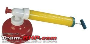

All spray guns use a powerful jet of air to atomize the fluid so that it gets applied more evenly. How do they work? Same principle as this household atomizer - but don't use this to spray your car :)
All about car dent repair & painting - Processes, methods & tools-mosquitosprayermosquitoessprayeratomizerhandoperatedsprayers.jpg

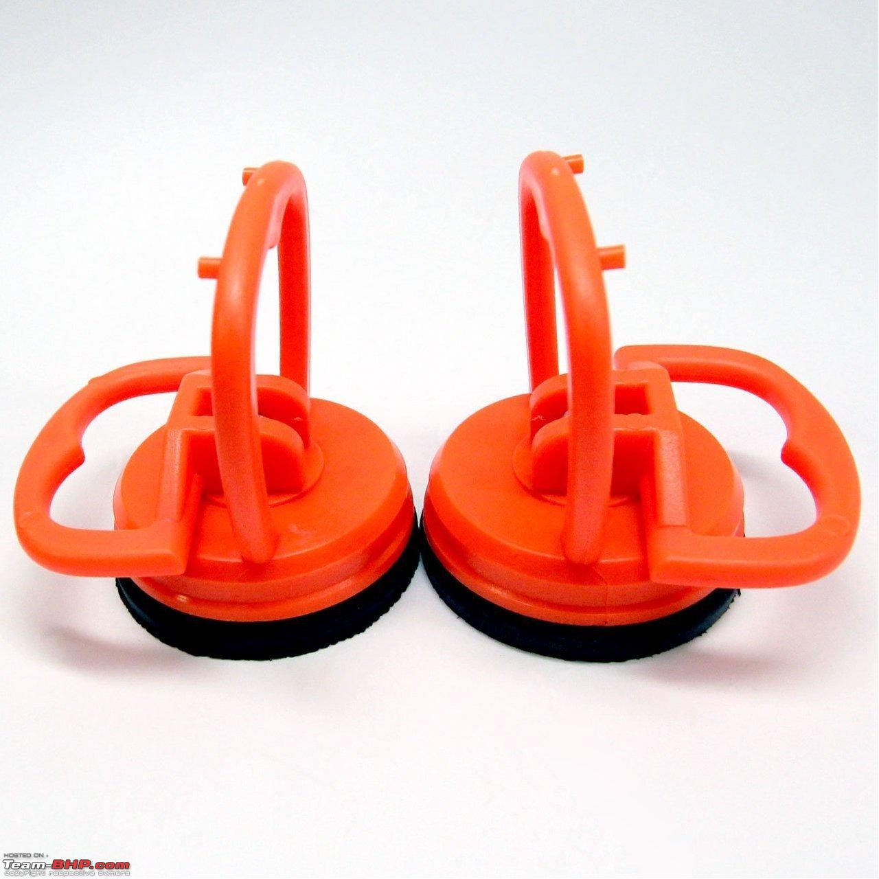

The other kind of dent puller is the air suction type. This again operates best on dents that have no creases. Their success is also measured by how much they flatten the said depression.
All about car dent repair & painting - Processes, methods & tools-71lwds9gwl._sl1500_.jpg
A poor cousin-the toilet suction cup, but just about as effective.

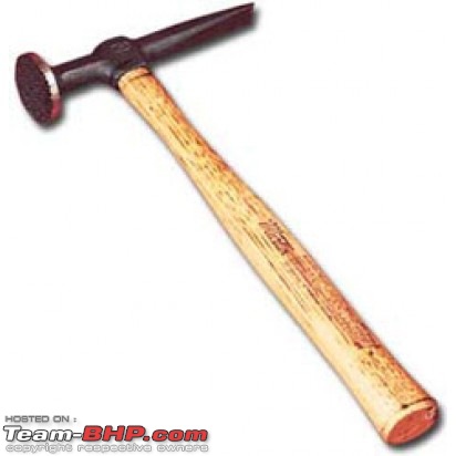

A ) Hammers

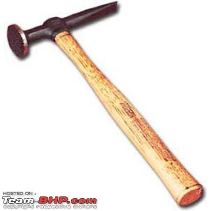

1) General Purpose Pick Hammer : General purpose hammer for body jobs
All about car dent repair & painting - Processes, methods & tools-general-purpose-pick-hammer.jpg

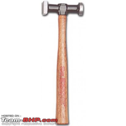

2) Bumping hammer : Heavier head with round and square faces for thicker metal;
All about car dent repair & painting - Processes, methods & tools-heavy-duty-bumping-hammer.jpg

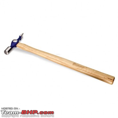

5) Pick Fin Hammer : works on restoring contours of dented fins e.g. 50's cars with nice tail fins!
All about car dent repair & painting - Processes, methods & tools-pick-fin-hammer.jpg

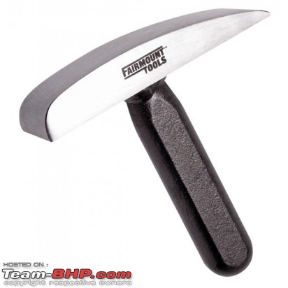

4) Slapping Spoon
Works well for smoothing and shaping.
All about car dent repair & painting - Processes, methods & tools-slapping-spoon.jpg

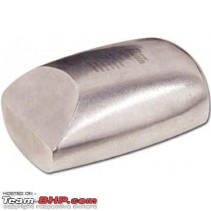

1) General Purpose Dolly
All about car dent repair & painting - Processes, methods & tools-general-purpose-dolly.jpg

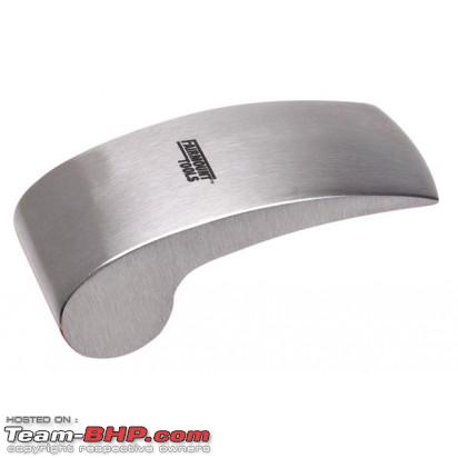

3) Anvil Dolly
All about car dent repair & painting - Processes, methods & tools-anvil-dolly.jpg

Dent-pullers vary in shapes and sizes. There are two kinds - the pneumatic type (vaccuum based), and the spot-weld type.
The pneumatic type have limited action and efficacy and are best suited for the amateur action scene. These have been covered above. The spot weld type, employ a combination of a spot welded key and a slide hammer assisted puller.

Rule 4: Full-tu painting the panel saar. It will be expensive.
Bollocks! Now that you realize what painting the panel really entails, do you think the hustler at the main dealership, or even at FNG is saying the truth when he says, your panel needs a full coat of paint? 9 times out of 10 the guaranteed answer is NO!
Usually, what they end up doing is a combination of the following
a) repairing the dent
b) filling and primering the affected area
c) painting 2-4 coats on the affected area, and feathering/blending in the paint with the rest of the panel - so it does not look out of place.
d) worst comes to worst, they will give a key to the entire surface, and spray paint 1 coat on the non-affected area, while feathering in 2-3 paint coats on the affected area.
All while giving the impression that he is painting the entire panel up from bare metal!
So the answer is - call out his bluff. Do your research. Talk to an auto-paint provider, and obtain a quotation for a litre of paint. Even the biggest panel does not require more than 1 litre when repainting as described here. Then beat him down on price.
