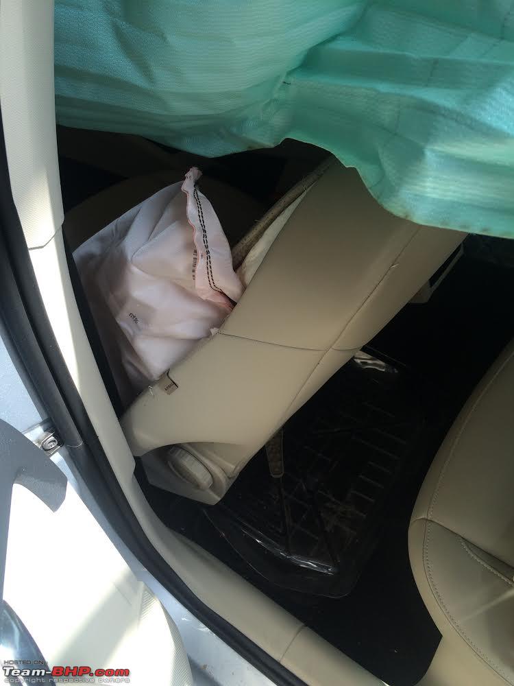

Brand new Skoda Octavia: Curtain Airbags deploy without impact / accident!
Shaikh Akbar recently faced this dilemma and shares his story with us.
He bought a Skoda Octavia DSG Diesel a few weeks backs. His car had 800 kms at the time of this incident. The Curtain Airbags (of the left side) opened without any collision or accident (speed of 40 - 50 kph). The front passenger door deformed slightly from the bottom, while the rear door deformed from the top. The protective plates (under the car) unbolted automatically. He checked under the car; not even a scratch on the protective plates, but they still opened up?
Skoda dealer in Kanpur has the car with him since the 15th of October. Dealership says 'we are still analyzing what has happened'. He's unhappy because he has yet to receive a clear explanation as to why this happened.
Brand new Skoda Octavia: Curtain Airbags deploy without impact / accident!-1.jpg
Brand new Skoda Octavia: Curtain Airbags deploy without impact / accident!-2.jpg
Brand new Skoda Octavia: Curtain Airbags deploy without impact / accident!-3.jpg
Brand new Skoda Octavia: Curtain Airbags deploy without impact / accident!-4.jpg
Brand new Skoda Octavia: Curtain Airbags deploy without impact / accident!-5.jpg

The vehicle in question does seem free of external impact. The damage on the doors alignment caused by the exploding airbag is quite visible. For one the driver must feel extremely lucky that it was the passenger side airbag which went off. Had it been front/driver side airbags it would've caused the driver to not only lose focus due to the sudden explosion for no reason, it would've also physically pushed his body/hands away from the steering.

Do you think the car met with an small accident at the dealers before delivery? Dealer did a quick fix and tried to dispose of the car?

Does these sensor work based on impact and in turn sending signals in the form of volts to the central unit. If thats the case i would even say rat bites at dealers stock yard.
More so that they would have found this and provided a quick fix which includes fixing the broken wire by tapes rather than soldering.
My o2 sensor had a rat bite and i tried fixing with simply cutting the wires and connecting. The voltage was quite different from the sensor and the ECU read as if the temperature is far higher than the actual which inturn made my AC super efficient in cooling(In other words was over working than it should).
This is my guess based on how these sensors send signals in the form of voltage and if indeed if the sensor malfunctioned it would have deployed the air bags thinking it was an impact.

I cant think of anything but a faulty sensor, even otherwise the fault codes are handled in such a way to have the airbags fail rather than deploy and show the warning. All these systems have been bypassed (hoping its there), it could be either an ill fitment of the sensor into the B-Pillar or some modification done by the owner that interfered with the sensors. Skoda really needs to get to the bottom of this issue!

It is not so easy to tell upfront why the chemicals were detonated unless there are trained professionals specific to restraint system. I have worked on one of several restraint modules and it is not easy. However if the A.S.S can take out data from ACU, it should not take much time to identify the reason for detonation.
All modern cars have Airbag control unit (ACU) which are linked to impact sensors, accelerometers, door pressure sensors, ABS, passenger occupancy sensors etc. Real time informations are fed to ACU from all these sensors and ACU can decide which section of Airbag it has to detonate based on the default set data. Malfunction of any one of the sensors or the connecting cables (usually called squib assembly) can result in such incidents.
Small impacts do not open airbags unless there is a malfunction.
Was there any airbag indication glowing in the cluster? usually, minor electrical problems will give an indication to driver.
Could be that the door pressure sensors are the culprit. Was this portion of door worked on by A.S.S before delivery?
