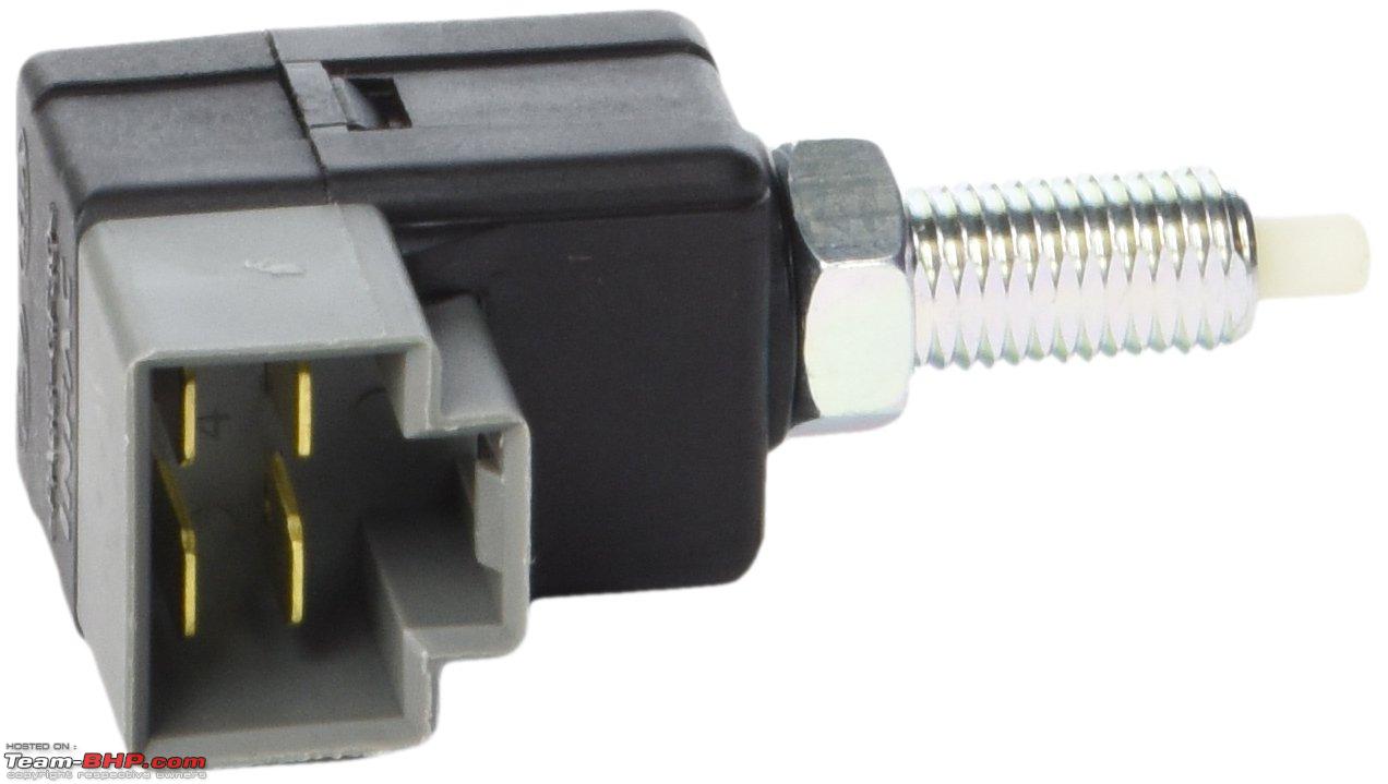

Old 26th August 2020, 16:46   #13
Posts: 87
Thanked: 93 Times
Re: Brake lights wont go off
Originally Posted by patel View Post
Do you mind sharing schematic of that transparent plastic part?
Hi Patel, This can be due to a faulty Brake Light Switch or the plastic part on the brake pedal which touches the switch.
decode is offline   (1) Thanks
Old 5th October 2020, 22:47   #14
patel's Avatar
Join Date: Feb 2020
Location: MH12, RJ19
Posts: 25
Thanked: 34 Times
You are right. On closer inspection I did find crumbled plastic part (a very small nudge).
Since I was on highway, with lack of better alternate I choose to put a right sized bolt/screw in the gap created after the plastic part departed.
Is there any harm in keeping this metal replacement as long term solution? I went to few near by mechanics none seem to have that part.
patel is offline
Old 6th October 2020, 16:09   #15
Posts: 87
Thanked: 93 Times
Your brakes will still work. There is a chance that the white plastic head on the switch can wear off quickly. I would recommend that you check with the authorized service center. Now that you know where and what need to done, it is a simple task.
