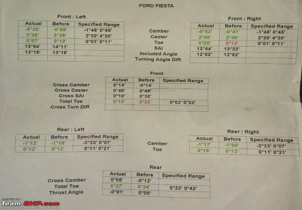

Originally Posted by humyum View Post
An overly excessive toe out can cause this kind of feeling of the steering being not heavy enough at speeds. Get a wheel alignment done from a competent guy and post the alignment sheet here please.
Thanks for the guidance. Please find alignment details. This was done at a reputed shop in my town about 5k kms before. The car had MRFs before which I changed to Yoko's after purchase. I had same issues even during MRf use which makes me believe it's something other than tires.
Things to do to an older engine to restore performance-picsart_080505.32.50.jpg
