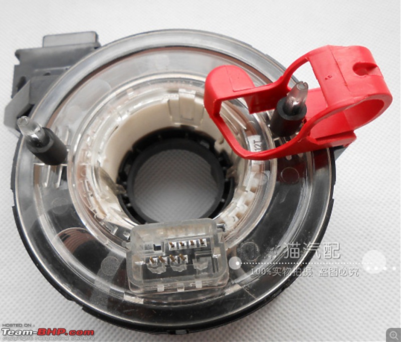

It could be possible that the clock spring, the one which keeps the cables connected when you turn the steering is broken.
Although it seems like a mechanical problem, do a VCDS scan and check for any other electrical errors. Attaching an image here.
IMO don't try the repairs yourself. You could end up doing unknown damage. The slip ring and the spring both are complex pieces of technology.

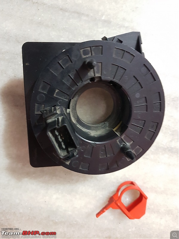

Manufactured in Baunatal, Germany - this explains the absurd cost of the part.
Same OEM part shared among VW, Skoda, SEAT and Audi.
The broken clock spring.
On dissection: clock spring prevents the wires (of airbag, steering controls and horn) from twisting upon themselves when we rotate the steering wheel. Second pic shows the point of breakage.
I had a talk with the mechanic and SA as to why it broke so easily. They pointed me some reasons:
1. Sudden and forceful full rotation of steering wheel. Doing this repeatedly is most common cause of broken springs
2. Tying religious shrouds around the steering wheel. It leads to debris collection in the spring which overtimes hardens and resist the free flowing motion of wires inside.
After a 1.5 months of patience I'm relaxed again. There's something bugging me all the time when my car isn't in top shape :P
Thank you all for the support and guidance! Starting to clock(?irony ) miles again.
