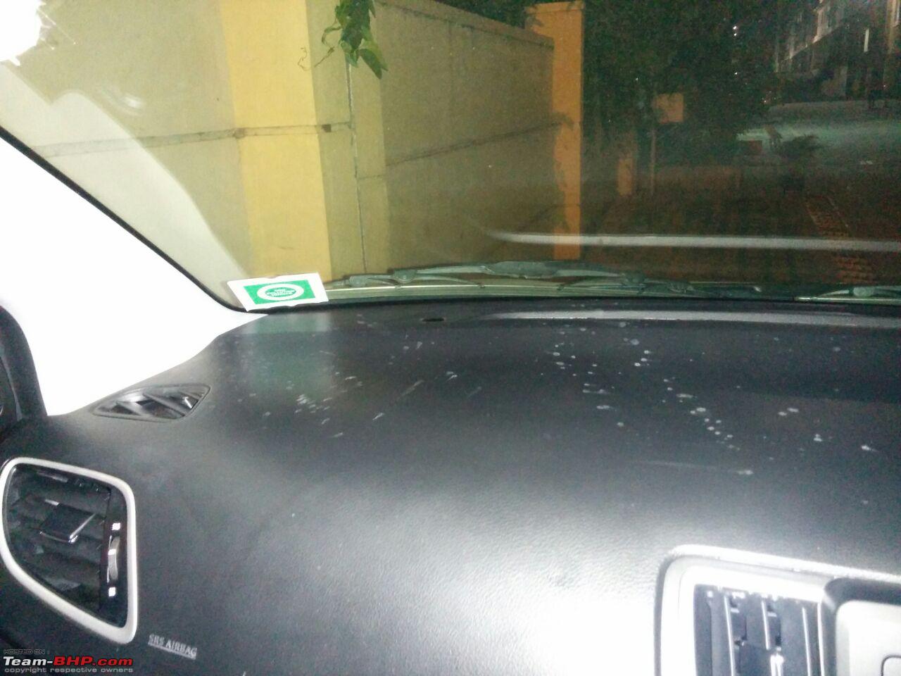

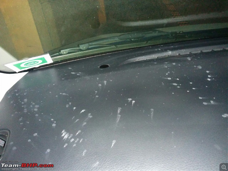

Hi All,
I am posting here on behalf of my good friend who is heartbroken after he discovered a few "spots" on the dashboard of his relatively new Baleno.
Here's what happened - he had given the car for an interior cleanup at 3M Car Care (JP Nagar Bangalore) and on receiving the car, he found lots of white spots on the dashboard of the baleno. On enquiring, he found out that the 3M staf cleaning the glass of his car had accidentally spilt/sprayed some chemical over the dash and that has caused the stains. From the pics, it looks like they have tried to wipe it off (see the trails) but it was too little, too late.
Obviously, my buddy was aghast and angry at the carelessness of the 3M CC folk and demanded a cleanup of the spots. However, whatever they tried, the stains would not go away.
After all this, the 3M folk have offered to do a PVC paint job (not sure of the exact terminology here - but I can ask for more details in some time) over the dash to cover up the spots as a remedial measure and as an apology from their end.
Attaching the pics of the stains below. Excuse the quality - taken from a mobile.

Here are my friend's concerns:
  1. What is this PVC Paint coating thing?
  2. Is it going to look bad/odd/out of place on the dahsboard?
  3. What are the effects of sun/heat/UV exposure on this paint? Wont it start cracking up/peeling off over time, leading to an even uglier dashboard?
  4. What are the other options? Any other remedies to patch those stains?
  5. Any other expert advice/opinions?
I dont know enough about the PVC paint thing but might be able to help with recovery of the damage.
Query:
What were the 3M guys using? The stains tell me it was a strong solvent, acetone, xylene or something. If yes, were they even supposed to using that in the car?
Possible fix:
Take some rubbing compound like the ones used for correcting car paint (Even brasso / non gel toothpaste would do)
try buffing just one of the stains gently with your finger. Does it dissappear / lighten?

Looks like, whatever that thing is, it completely bleached the places where the spots have fallen and to do that, the compound would be extremely strong IMHO. It's a heartbreak to see such damages on a new car. I too feel that they should bear the expenses for the dashboard replacement. They dont come in that cheap and they should realise that their mistakes would be costly to them too.
They say that it's cheaper to learn from someone else's mistake and one thing which I learn from your friends unfortunate experience is - "Never ever leave the car out of your sight at these detailing/service centers, no matter how good a reputation and experienced staff they have." Be with your car like a shadow till the treatment/service has been done and take it back with you.

That looks awful. My heart goes out to your friend.
It is 3M's mistake and they must pay the price. Visit the authorised workshop and see if they have a solution. It could be a lucky visit. If not, get a quotation of a new dashboard from them. Also visit a top detailer in Bangalore (e.g. Ultimate Detailers) & see if they have a fix.
Please also get in touch with Interior Glo (related thread) for advice. They are masters of interior restoration.
I don't usually recommend a legal recourse, but in this case, it might be necessary. Sue them in the consumer court. You will get the cost of a new dashboard + your legal expenses covered. They goofed up - transfer your friend's heartache to them.
In the meantime, your friend could also try a dashboard cover, dashboard paint, carbon fibre sticker & the like. Please search the forum - there are threads on these topics.

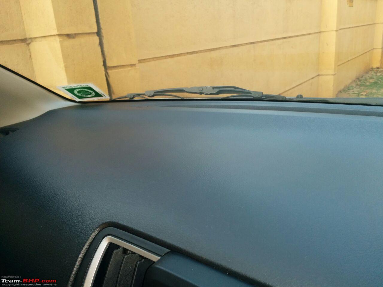

UPDATE:
3M got the car's dashboard repainted with some "PU Coating" and the end result seems OK. Attaching a pic of the job for reference:
3M Car Care Goofup: Removing chemical stains from the dashboard?-whatsapp-image-20170111-07.30.02.jpeg
My friend tried to see and identify what was there in the glass cleaner that caused the spots, but he couldn't - since the liquid came in a bulk-use container (like those cooking oil cans) and did not have any sticker/label on it.
As of now, the dashboard seems to be restored with the PU Coating (which incidentally was carried out at Sai Colorium and not by 3M!!!). My friend seems to be OK with the PU job and like all of us, he's just happy to have his car back with him (don't we all love that feeling!?!?! )
As a consolation, 3M offered to do a complimentary Paint Protection Film installation around the door handles, apart from bearing the cost of the PU paint job.
I'll update more details/pics as my friend shares them with me.

Re: 3M Car Care Goofup: Removing chemical stains from the dashboard?
UPDATE:
That looks like a brand new dashboard now. A good gesture from them to throw in Paint Protection Film but ask your friend to get a note from the shop owner about the warranty of this job. The damage was to the top portion of the dash which gets expose to Sun very easily and this paint job may show some adverse effect of the same.
