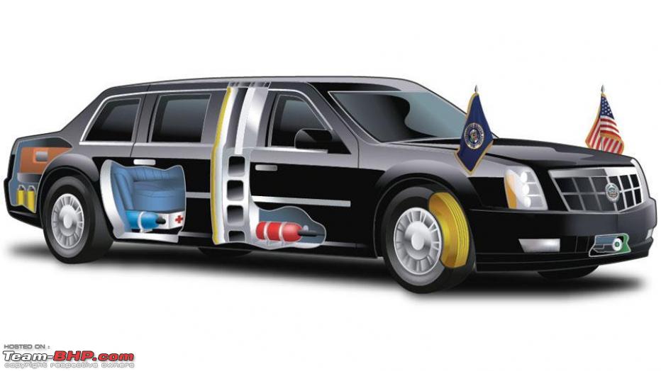

In a typical 1980s movie, cars used to roll down the hill and then go 'BOOM'. Nowadays, even movies don't show that. As Jeroen says, fires are quite rare.
But if you need ideas, just look up fire protection features of the Presidential Limo.
Auto fire detection & fire extinguisher system in all cars - why not?-131019838.jpg
1) Foam covered fuel tank
2) Foam covered fuel lines
2) Automatic fire suppression system that uses an inert gas to put out a fire
https://en.wikipedia.org/wiki/Gaseous_fire_suppression.
I guess weight is the biggest disadvantage of implementing such a system in all cars (along with costs).
