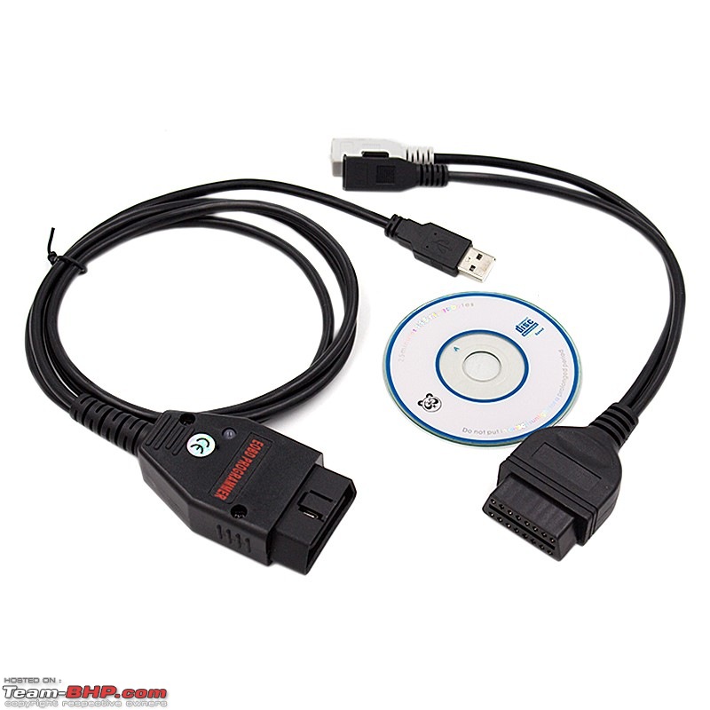

For quite some time I've been going through a compulsive instinct to get a cheaper affordable tool to make minor tweaks to my cars ECU on my own & have been searching online.
The cheapest I could find was something called the Galletto 1260. It comes with the cable & the software too(probably a cracked one) for just about 10 US dollars exclusive of shipping charges which are also quite nominal. I am attaching a standard image available on almost every Chinese website that is selling this.
Does anyone on the forum have any idea about this? Also, if someones aware of some alternate tool, even if its relatively expensive, please do share details and feedback regarding first hand experiences would be greatly appreciated.

What do you mean by the "basic stuff"?
What I know is that when you're in the brain of the car, the only things you can fiddle with is the maps/timings etc. Or nothing.
My suggestion would be not waste your money.

There are many Chinese clone tools. Some work and some don't. Also, these tools can brick your ECU. Even if you get the ECU read from these clones.. You need a tuning software like Winols / ECM Titanium / Swiftec etc to tweak the file. Again, you can get "cracked versions".
Remember you would be using clone and cracked tuning software and risk quotient is very high.
Want to do a safe remap yourself??
1. Invest on master tools
2. Get a licensed tuning software like Winols
3. Learn to identify maps. You can also buy DAMOS / Map packs for the ECU version you are interested in.
Well, this would cost around 10 lakhs if you need to do a safe tune on your own
