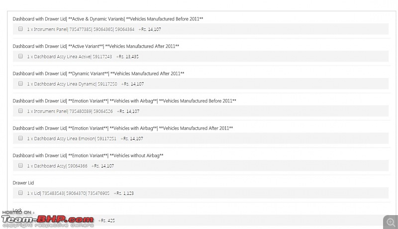

Dear Ranjith,
I also had somewhat similar issue with my Punto's dashboard just after 3 years of purchase, I've never applied any aftermarket polish on my dashboard always used 3M interior polish to clean interiors, when I showed my dashboard to FASS they straightaway refused to help and blamed me to have applied some local dashboard polish on frequent intervals, which in result have spoiled it.
"Inferior plastic quality" is purely to be blamed here, there were many other FIAT' s going through the same plastic quality issues. Early 2010-2011 lot of FIAT's were most affected with such poor plastic quality dashboard with paint peeling off in patches, mine is 2010 model and there were couple of patches with chipped paint, I asked for extended warranty which was denied, as FASS said it's me who have spoiled the dash and there is no problem with the plastic and QC.
I was not ready to buy the justification given by FIAT, hence I wrote to FIAT MD and got the same changed under goodwill.
Assuming yours is Linea emotion-pack with Airbags, Attached two pictures, one is from my punto and other is for dashboard price. (Source www.99rpm.com)

Originally Posted by varoon9999 View Post
Dear Ranjith,
Hi Varoon9999, thats some news, I did not expect it to be of such bad quality. Good to know that they replaced it for you, I am simply terrified of arguing it out with the FIAT service folks, last time around they would have ended up killing me and my family because of their carelessness, I have to write up a specific post on that one though.
Anyways once I am back in April, will take it up with the Service team. Thanks a lot for the pics and pointing me to cost of the dashboard. I will check with Bosh service guys if they can replace it for me that is if nothing else works out.
