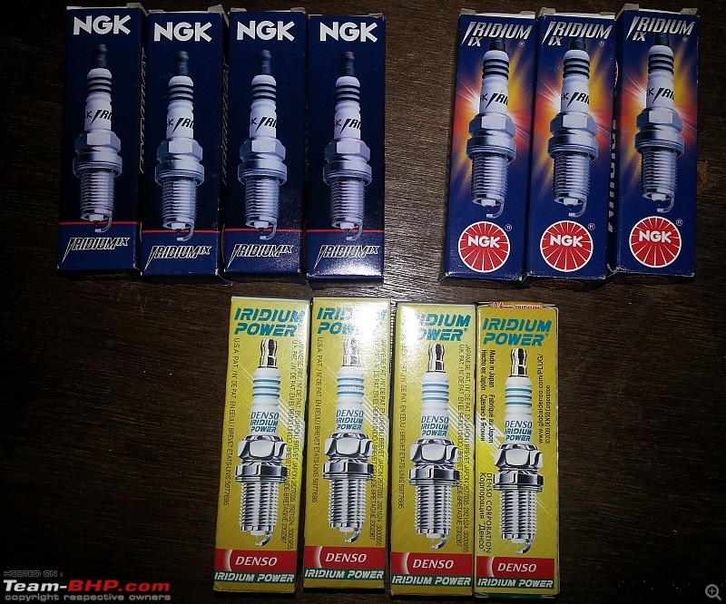

I bought the torque wrench mainly for these jobs:
I bought and experimented with NGK and Denso Ir plugs for my car and felt very little difference between them and the stock Denso (non Ir) plugs. I felt the Denso Ir were better than the NGKs and they're installed in my car till today.
Can you kindly find me the proper plug in Denso?? NGK model was DCPR7EIX
Worth the money? For me yes (since I like the 100K Km change interval, plus the ever so slightly better increase in AP response and a rock steady engine idle). YMMV of course but I'd frankly advise everyone to hold off from upgrading. You'll save a few 1000 bucks that can be spent elsewhere on the car.
Its worth for me too. But one shouldn't expect too much difference in engine output. I mean if someone is value conscious then definitely not. In my case, it solved the jerkiness with AC lower down the revv range. To make sure it wasnt a placebo effect, I swapped with normal plugs and the jerkiness was back along with the erratic idle surge(cannot be felt but one can see if SDT is connected.)
