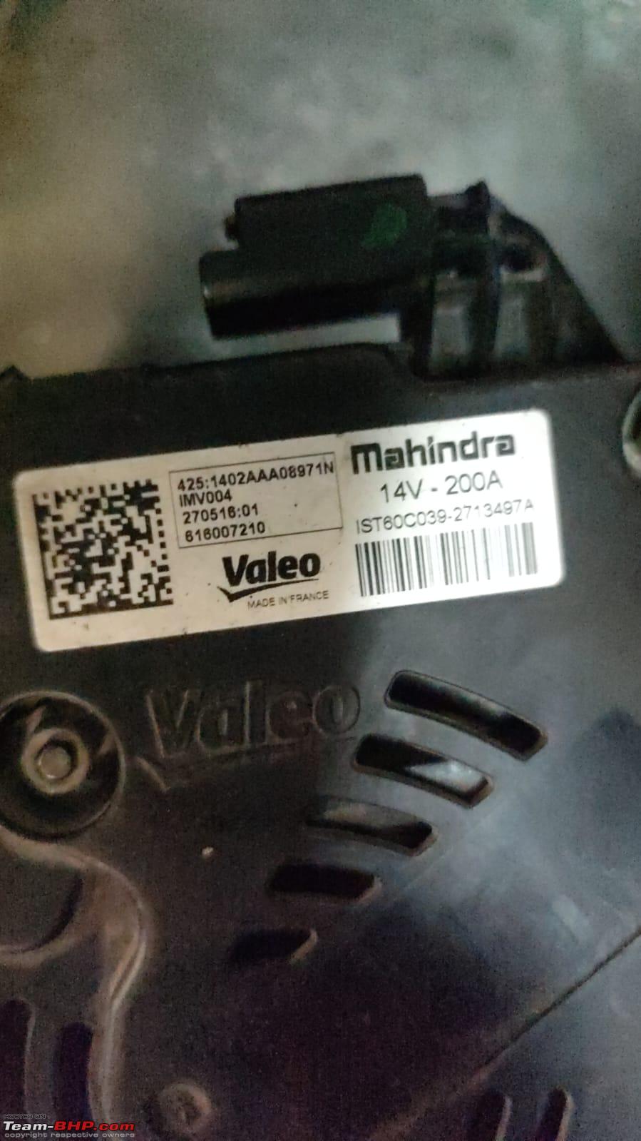

For my Scorpio s6+ Intellihybrid Mahindra service centre quoted 1L+ for alternator replacement as parts are not available for repair, as apparently this alternator was used for just for small number of Intellihybrid versions, what are my options I am in Noida and no when has spare part to repair it.
Alternator problem: Repair or replace?-0d59c956d84f43bf93e29a43bce723fd.jpeg
Find out what is wrong with it.
. If it is mechanical - bearing or bushes, then any good auto electrical shop can repair.
. If it is the rectifier diodes, then find their rating. As Mahindra does not manufacture the rectifier, there should be a part number on it. I all fails search online for rectifiers for 200A alternators.
Alternatively you can search for 200A alternators meant for RV.
https://www.amazon.com/200-amp-alter...amp+alternator
https://www.ubuy.co.in/product/QM3WP...-dsl-bosch-012
You can even ask some body to get it from US.
