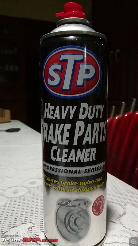

Cleaning out the pads, rotors and calipers with brake cleaning spray. Used a full can of STP, followed by another can of Würth spray. Würth seems to dry out slower, but cleans better.

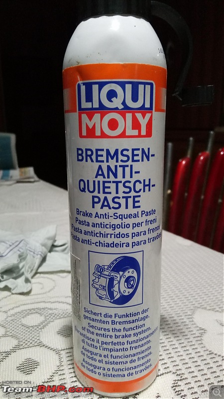

This is the Liqui Moly product, and the product video:
Unfortunately, Amazon omitted to send the dispensing brush, and sending back the product and asking for a replacement would take another few days. So we dispensed the paste and applied it using nitrile gloves. A little overapplication here, but we were very, very careful to avoid getting the stuff on the friction surfaces.

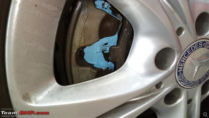

Work in progress:
That's how it looks finally:
