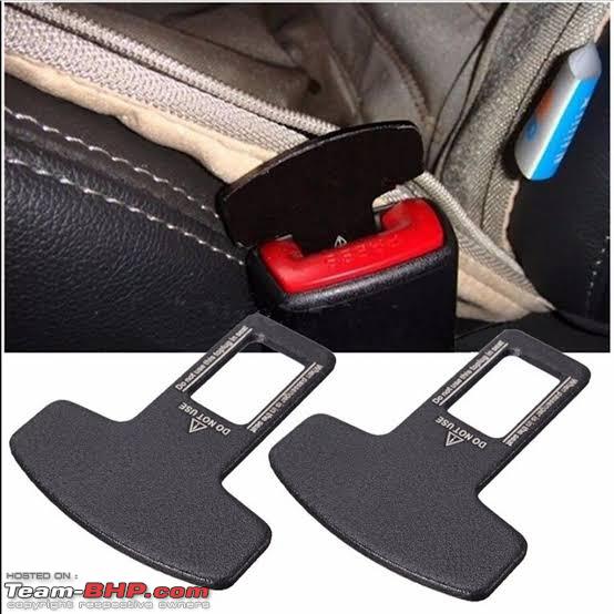

Probable these found on AliExpress will be of better use!
- No irritating alarms
- Passenger can buckle up whenever
- Cost effective solution!

Originally Posted by coolboy007 (Post 4601031)
Indeed, the service guys just shrugged it off and said its not too much of a hassle to pull the passenger side belt and bolt it, other Marazzo owners are doing the same thing.
So in case a Marazzo or any Mahindra engine fails to start one fine day, will they advice to use Uber or Ola as it is easier than fixing the engine and will reduce the stress while driving a car. Work around is done when the fix is not readily available, but in this case they know what to be fixed and where. So a work around is not what is expected out of a good ethical company.
Attachment 1882826
Attachment 1882827
https://m.aliexpress.com/item/328987...N1559926501047
even simpler would be to unlatch the switch from under the seat. Would that not work?
