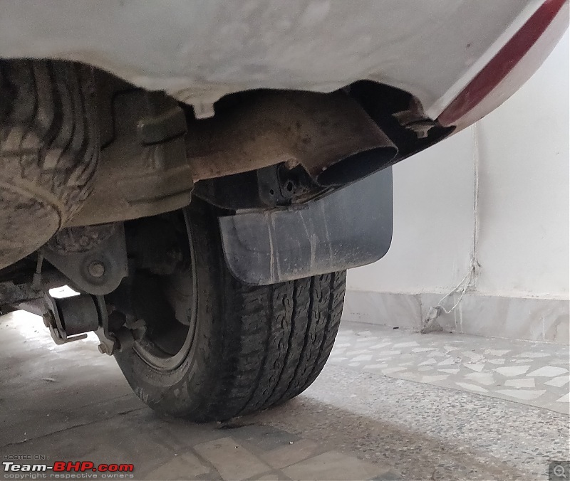

5. At present light smoke coming from the exhaust. I am posting the pictures of the exhaust but the haze from the smoke is light and does not register in the picture. I could see the smoke only because the car was parked inside and the smoke accumulated. Colour was greyish white.
