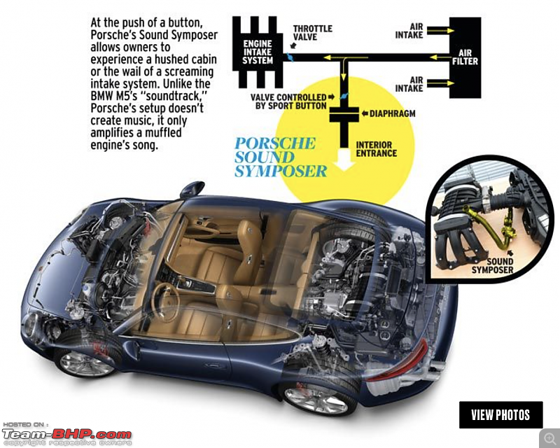

I'm definitely against synthesised fake sound. However, it's too much to expect a raucous engine note in the cabin when luxury buyers demand low cabin NVH. The Porsche 911 & Panamera GTS pumps in the actual engine note which I think is a win-win in such a situation. Again, this costs more than a synthesised engine note and is probably only justified in a genuinely sporty vehicle like a Porsche, an AMG or an M car.
Active Noise Cancellation launched in Genesis GV80 - Good or bad for future cars?-screenshot-20200307-16.37.14.png
