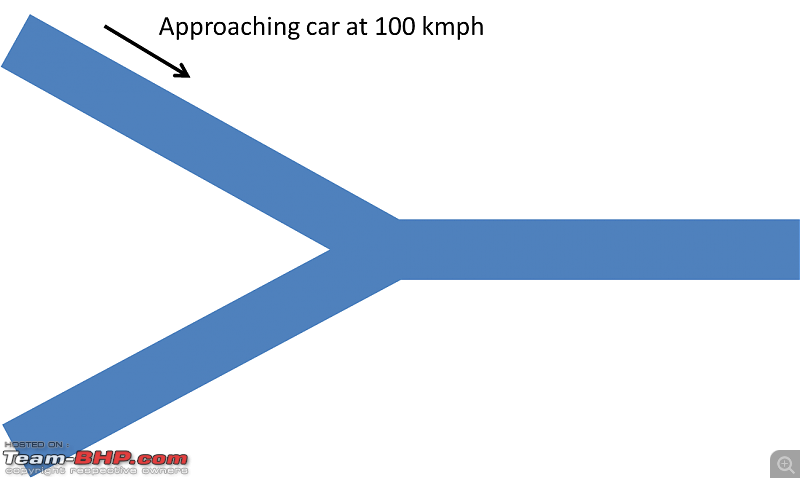

To understand why, imagine you are driving down the road shown in image 1, which is a typical Y-intersection. You are approaching from one arm of the Y in the direction of the black arrow at 100 kmph. You see the intersection ahead, there’s nobody on the road, and you end up reaching the intersection and going along the straight arm without any issues. That is similar to what a fluid element will behave near the end of a teardrop shape.
Image 1 - Y-Intersection

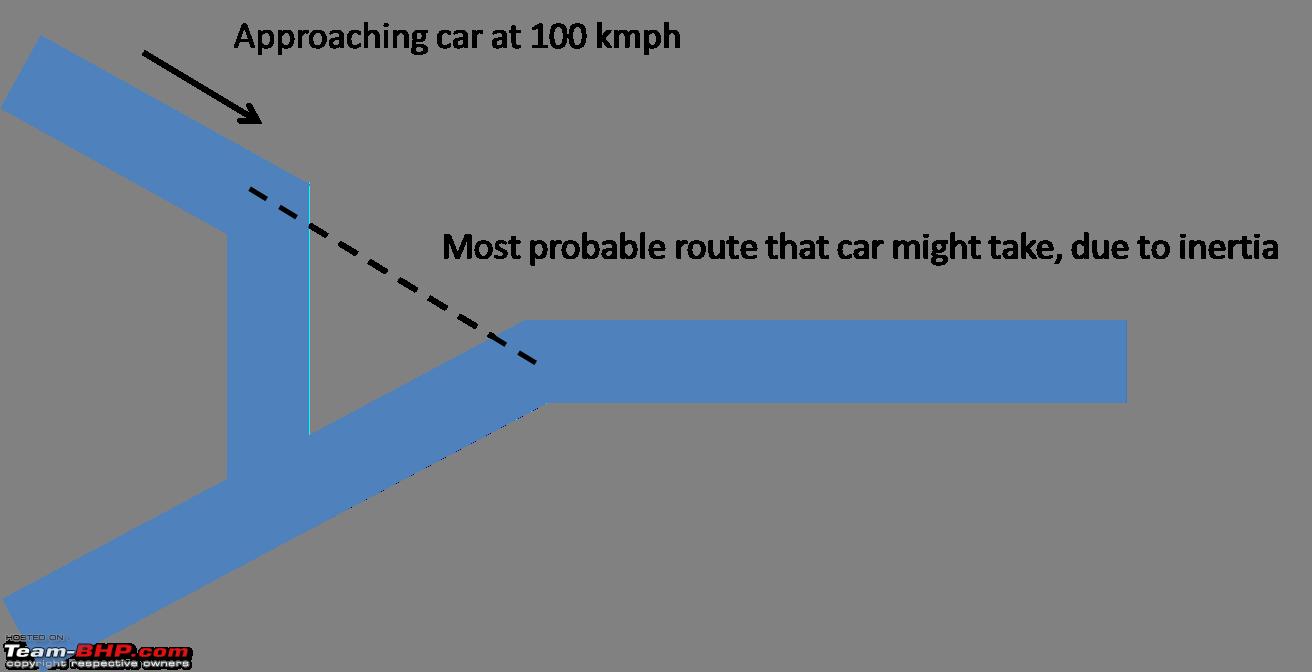

In the second case, for some reason, the Y-intersection is truncated (image 2) and there is no warning. The road designer expects you to take a sharp right turn and a sharp left turn to reach what would otherwise be the original Y-intersection. But if you are approaching the intersection at 100 kmph, that right-left manoeuvre is probably not going to happen. In most probability, you will overshoot the road and end up right where the original intersection was supposed to be. That is similar to how a fluid element will behave with a Kamm back (essentially, a truncated teardrop). It does not “see” that the shape is missing.
Image 2: Truncated Y-intersection
