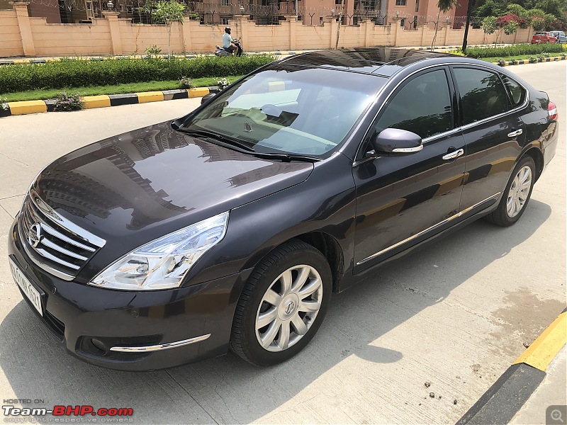

Wow superb buy.. I bought a 2011 Teana 250XV with 43k on odo in 2015 and sold it last year with odo reading of 79k. Usage was almost exclusively on highways as I had a smaller car for the city. Did multiple Bangalore- Hyderabad and Pune- Bangalore, Mangalore trips and nothing beats this super sedan in terms of highway comfort. Wish you many many years of happy ownership. Last pics of my beauty before I let her go.

^^ Your beauty looks smokin' hot !!

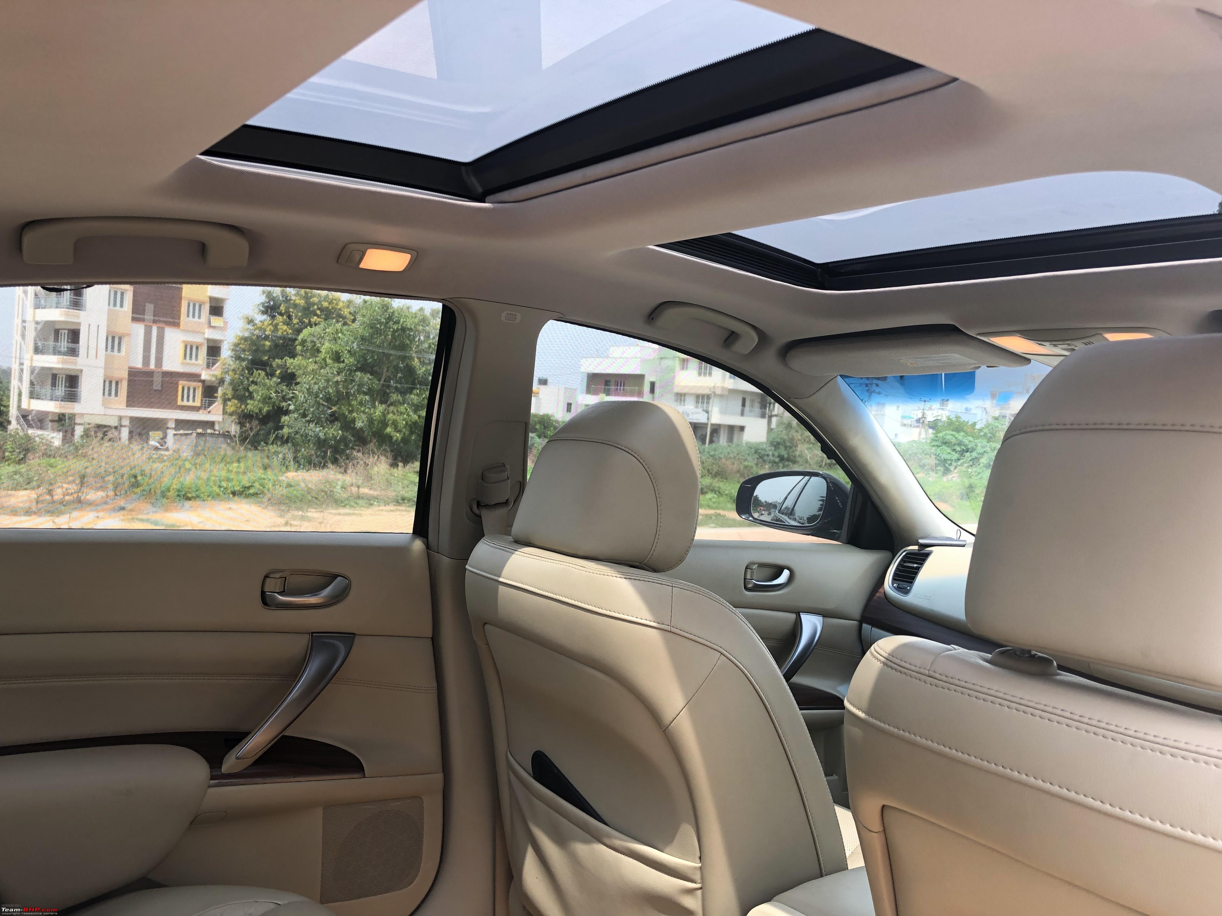

How were the interiors when you let her go? I was also apprehensive of the car's dashboard developing cracks (chronic issue with Teanas in some weather conditions), but our example had none of that.
The Ottoman seat was a nice feature.

Mine too had a dashboard crack next to driver side AC vent. In 4 years of my ownership I did not have any other cracks. Other issue is dashboard gets little sticky under heat. Both are common issues in Teana and can be controlled to an extent by putting up good windscreen uv shield and covered parking. Some pics of interiors too..
