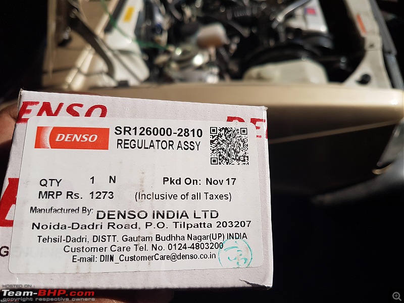

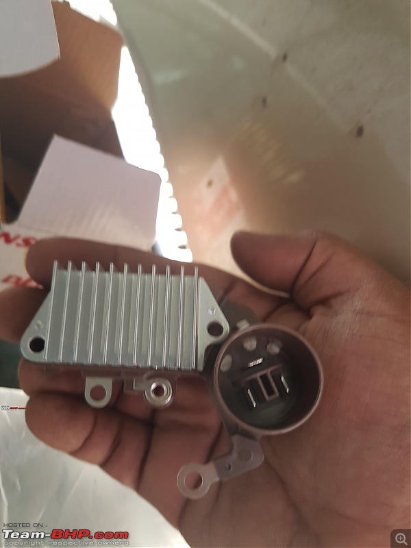

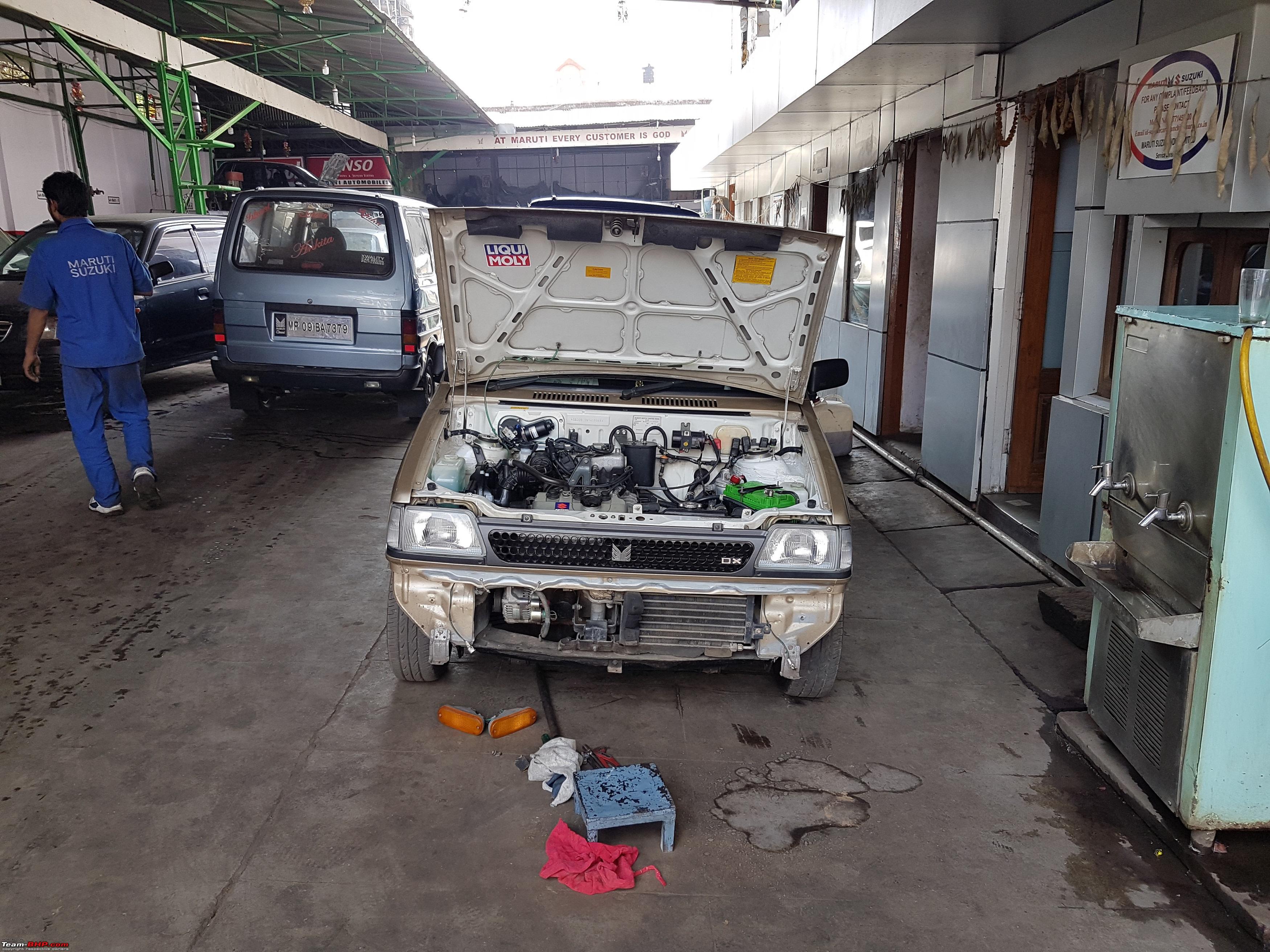

Originally Posted by CSA View Post
First thing there is no part number available for Voltage Regulator in Maruti Suzuki Parts Catalogue.
But there are child parts available in Denso or Lucas TVS and that's what workshops use to overhaul the alternator. MASS used similar Denso parts in my 800 too.
