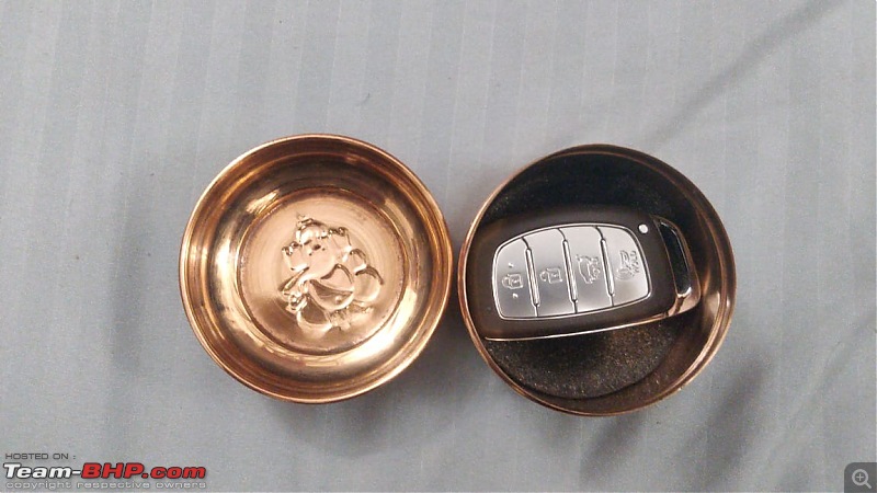

This is when a lightbulb went up in my head and I thought, "Why not store the fob in pure copper vessel?". Some research on Amazon.in threw up this product as a well sized container. It was also returnable; perfect for my experiment.
Using a copper 'dabba' to prevent theft of keyless entry cars-image_20201103_144608.png
https://www.amazon.in/gp/product/B01...?ie=UTF8&psc=1
The copper 'dabba' arrived a few minutes ago and I promptly lined its base with a circular cut-out of foam salvaged from a Paul John Whisky canister. I put my Hyundai Creta key fob inside. It fit just right. Walked up to the car. Lo and behold! The ORVMs did not unfold. Pressed the unlock button and nothing happened. Sweet success!
Using a copper 'dabba' to prevent theft of keyless entry cars-whatsapp-image-20201103-2.31.40-pm.jpeg
Really can't think of a better solution to protect your car from high-tech thieves at this price point. It is perfect for storing the key when at home. The 'dabba' is inconspicuous and Lord Ganesh embossed on the cap kinda checks off as well. Now, I need to find something that can fit in my pocket for storing the fib when in office or out and about. The Aliexpress pouch should work but I'm wondering if there's a simpler domestic hack for this too

Electromagnetism 101 everyone!!
Electrical permittivity inside a closed metallic sphere is zero.
An ingenious solution to a modern problem. Though, carrying the dabba around in your pocket will be inconvenient. And the dabba will rattle where you place it in the car.
Yep. The idea is to keep the dabba in my house, without worrying that someone can stand below on the road or at the gate and latch onto the RF signal from the keyfob.
Still haven't found anything for keeping in the pocket after parking in office/mall/market. A copper lined purse might be ideal. The search is on.
Ingenious solution to the problem.
While the "dabba" is fine while at home. For outside, I think it can be custom made by our nearby welder/metal shop. Just buy a small copper sheet and get it shaped from metal worker with the same outer shape as your key with a copper cap lined with foam on the inside.(just like a refill(your key) inside a pen's body(hand made copper key cover)!)
That's a good idea. I was initially thinking of approaching local jewellers to see if they can make a copper lined pouch/purse but the 'lohaar' should also be able to execute something along the lines of what you suggested.
