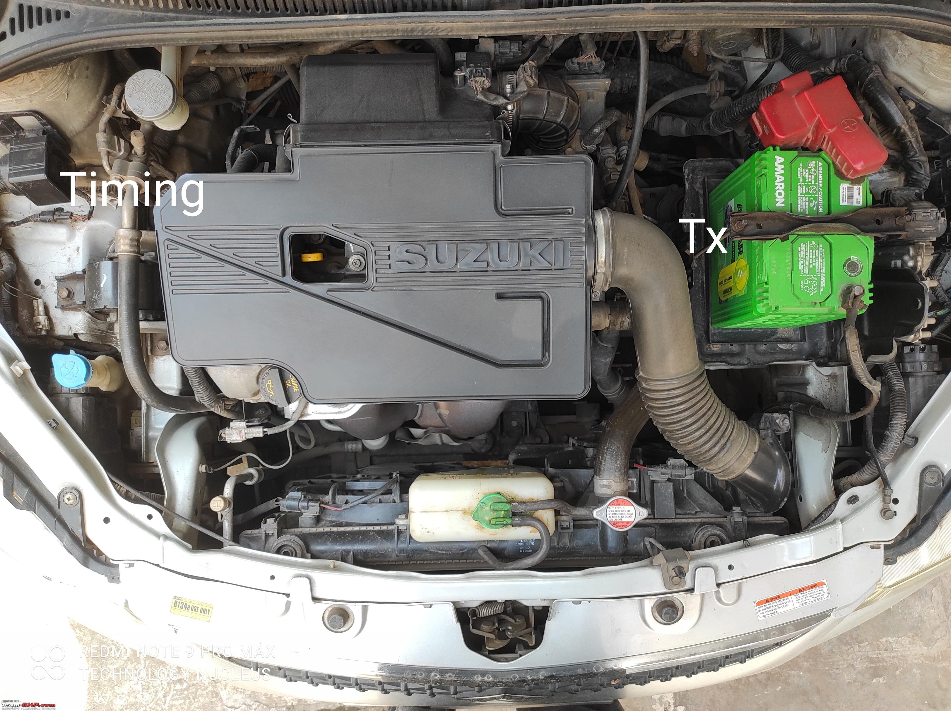

The picture I posted is a screenshot from a youtube video about how to set the timing while fitting the timing chain in Maruti Suzuki SX4.
I would like to do such stuff myself after adequate homework. I already have the tools & the space. I do carry out routine tasks like air filter change, cowl cleaning (underside), wiper blade change, cleaning the engine bay, headlight bulb change, headlight alignment etc. I would also like to do the oil change myself but I have been getting it done from a trusted and competent mechanic in the neighborhood, who does this in my presence. When he was busy, I have done a few underbody jobs like changing the fuel filter, bleeding the clutch and brakes to take out all the old oil in the system.
After watching this video, I am very much tempted to do this job when needed, but I will entrust this to my mechanic. From the video, it appears that MSIL has made it simple (and less prone to mistakes) to set the timing with a new chain. There are alignment marks on the pulley & the cylinder block casting. We need to align the two links on the chain (having different color) with these marks.

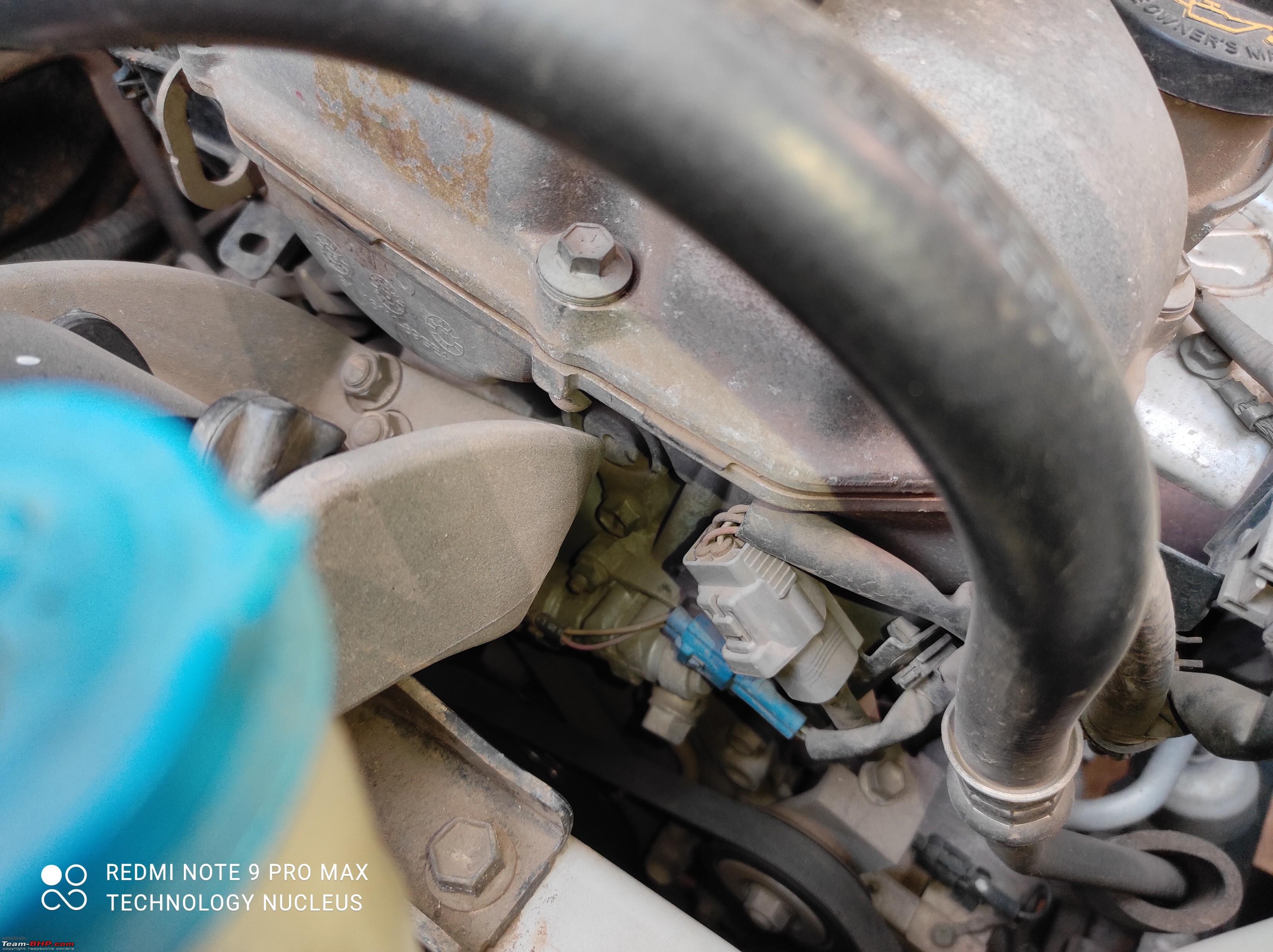

As seen in the photographs below and in the screenshot in my earlier post, one engine mount needs to be taken out to remove the timing cover. On the flywheel side, there is ample space for hands and the tools.
The photographs below are from my car.
