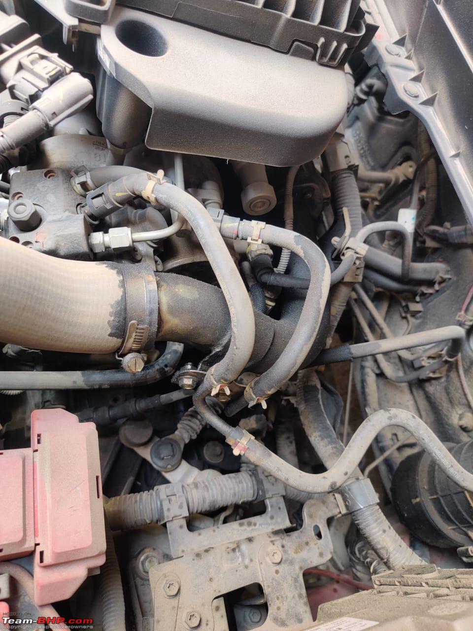

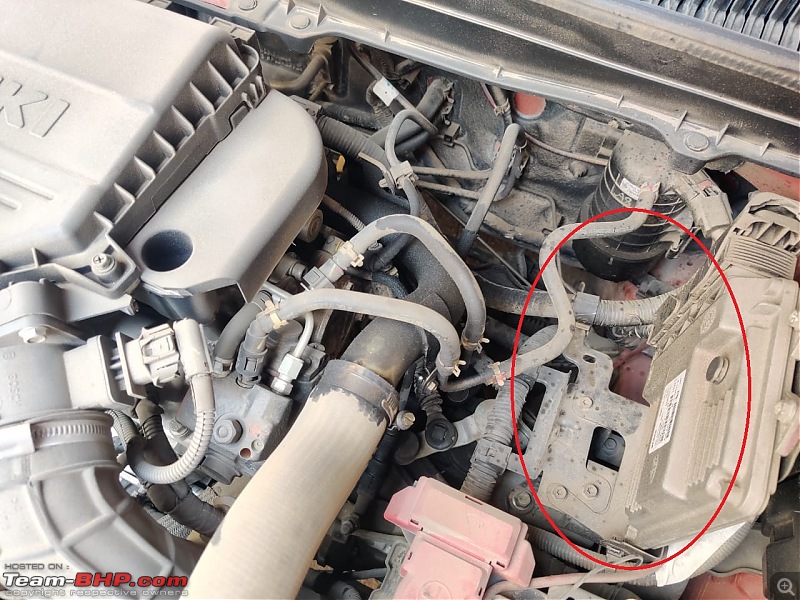

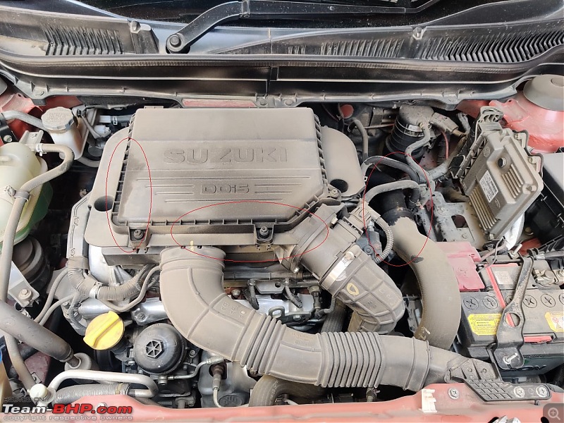

I own a 2018 Maruti Suzuki Brezza and this morning I popped the hood to refill the wiper water tank. To my horrific surprise, I saw oil residue all over the engine bay. This has never happened in the past and I don't know when and how this started. I saw unbelievable oil splatter marks all over the right side of my engine and oil leak/residue in the middle and the bottom half. There are oil stain even on the cover of the air filter box. Not sure what and how this happened but never seen anything like this with any of my other cars, 2 of which are diesel and more than 8 years old.
I keep my cars in very good shape, get them regularly serviced and have a very sedate driving habit. The car runs stock and everytime the bonnet opens for a checkup, it is at a MASS only.
I haven't used the car since the time I saw it. Attaching pictures for better understanding. I'd truly appreciate any expert guidance on this. It'll be helpful because then I go and ask the SA at MASS exactly what I need instead of letting them take me for a ride (which happens almost every time I visit them with anything and ask for their opinion).

Hard to say without checking, but I have seen such oil stains in cars with oil in intercooler. Maybe your turbo has some play in it, weakening the oil seal, so some of that is seeping into intercooler. If that's the case, there will be some amount of dark smoke from your exhaust.
In any case, get it checked ASAP.

As you have mentioned the vehicle runs stock.IMO, there isn't any serious issue with this oil leakage. May be there might be some loose clip in the EGR (exhaust gas recirculation system). To self check the car prior to taking it to MASS.
1. Perform a visual inspection at intercooler, it's hose and connections, near turbocharger, and under body.
2. Clean the visible area in the engine bay with a damp cloth and then with dry one to avoid unnecessary suspicion.
3. Check the engine oil level to know whether there is a concern or not. Providing a link for how to inspect the engine oil.
4. Start the engine, wait for 10 sec and check for any warning lamp glowing in the instrument cluster for either engine or wiring (spring type) symbol. If, you find any of these please contact the dealer and ask for arranging a technician to get it inspected and if they suggest the vehicle can be driven to workshop you may handover the vehicle to them and if in case of the issue is not worthy for driving please get it towed by RSA (Road Side Assistance). If, there aren't any warning symbols then, gradually rev the engine upto 2000, 3000 and 5000 rpm hold it for few secs and release the pedal. One person may stand at the front section to observe for any abnormal sounds like whistling or air leak. If you aren't able to find any drive the vehicle at nominal speed 40-50kmph to the service station or call them, briefing your concern and avail pick up service (do inform to provide a technician to inspect the vehicle before it is driven to avoid any surprises later).
I hope my voice is relevant to your concern and may this procedure lead you to the right outcome with a positive note. Waiting for your further update.

Did you check the bay while the engine is running, very difficult to predict since there are turbo hoses, hydraulic hoses, and fuel lines in there and one of them indeed seems to be leaking. First, start and see if there is anything apparent that is showing, if not slowly drive to the nearest service or call them home. Whatever it is get it checked and let us know what it was.

The thick pipe looks to be the Charge pipe, this is a turbo no?
Charge pipes generally have a lot of oil because of blow by, but this is more than I've ever seen. I understand your concern, but take a little more time and figure out where this leak is coming from, and what that part is. Simple troubleshooting and diagnosis.
It's an easy task for a bhpian
it may be MASS, but why rely on the ASC for everything. Since you didn't notice anything amiss, it's probably fine. Otherwise a CEL( check engine light) would've popped up.
My guess is, that a clip somewhere gave up. Don't sweat it.
Keep us updated.
