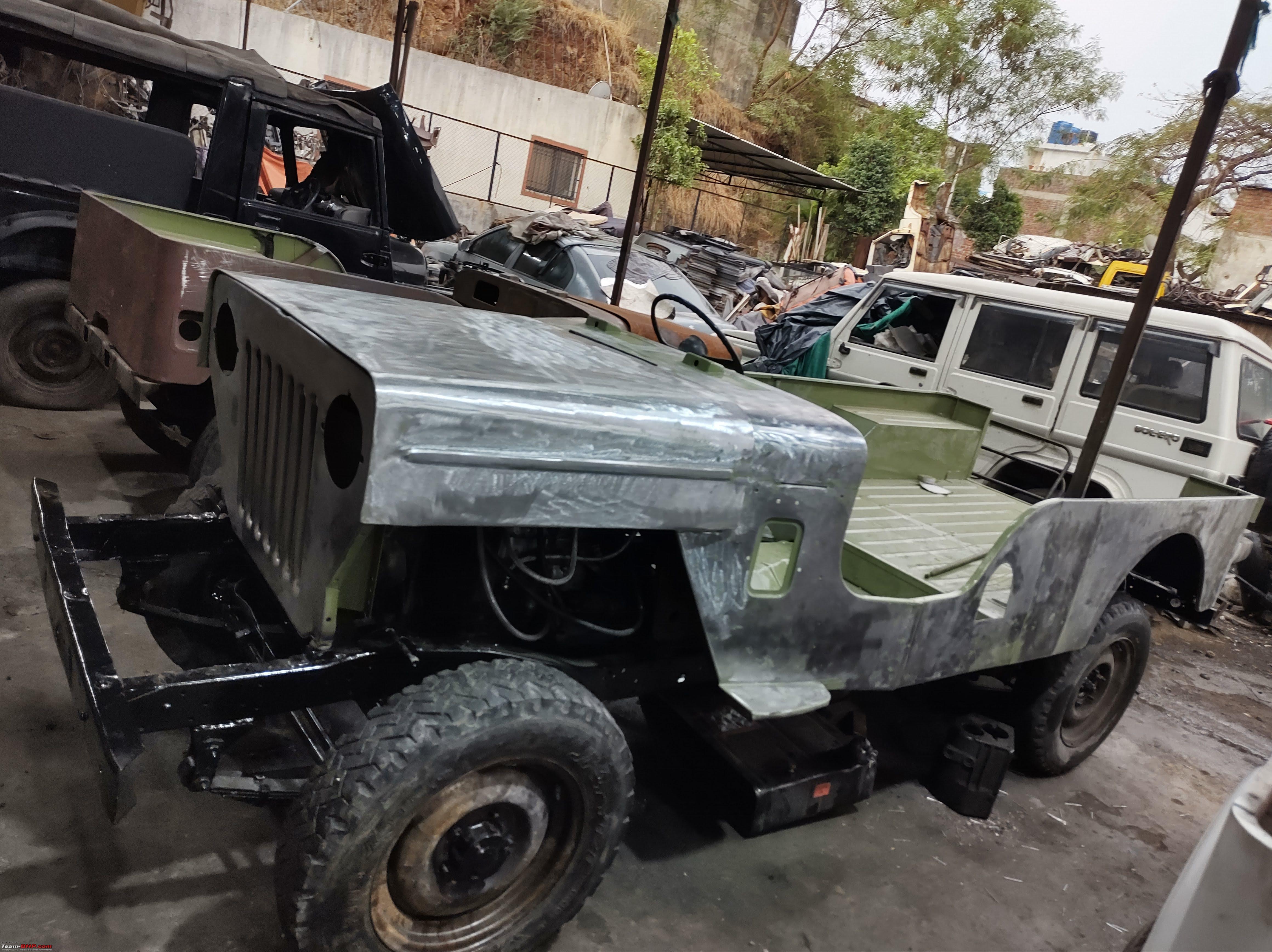

Work update #3
Chassis painting completed.
After a long wait caused by the lockdown restrictions body kit and hull has finally arrived. Any idea where these are fabricated? The mechanic says it was fabricated in Gujrat.
My 1983 Mahindra CJ 500D Restoration Project-img_20210426_155851117_hdr-1.jpg
My 1983 Mahindra CJ 500D Restoration Project-img_20210426_155856341_hdr-1.jpg
Body installation is also almost complete.
Painting shall begin by tomorrow or day after and the vehicle shall be ready for testing after that once the electronics are fixed.
I'm worried the brass bushes for the leaf springs must've worn out. The mechanic isn't really concerned about it. Should I insist on get them replaced?
Any final work checks I should do before the jeep leaves the garage?
Out of curiosity I kept checking other jeeps and their engine bays, I found a jeep with a Toyota 3 cylinder 2.4 L engine. Upon enquiry I got to know that this engine was a boat's engine. Is this common?
How do these engines perform in comparison to engines for road use?
Where can such engines be purchased?

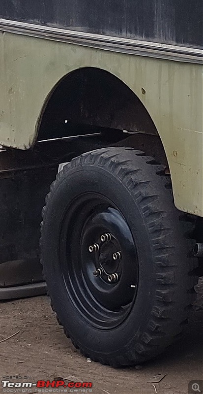

Here's a video explaining how I painted my rims:
Attachment 2150513
That’s a niche rebuild coming up, your mechanic might be right about the body being fabricated in Gujarat. A lot of old Jeeps ply in north Gujarat and Saurashtra as people carrier which are mostly altered in possible means to accommodate maximum headcount.
As far as altering engines is concerned, this was a common practice back in 80s and 90s since the Indian car makers didn’t have engines that were build to last. To quote an example, my father owned a CJ3B Jeep back in this days, the Jeep was bought from a government auction and came with the original petrol engine. My father replaced the petrol engine with a Diesel engine from a matador. Benefit was it could haul load better than a petrol engine, down side was you can’t drive it at speeds more than 60kmph else the engine will overheat. Somewhere in the mid 90s the Jeep was sold and my father bought a pre owned Ambassador. Best part was the matador Diesel engine was removed from the Jeep and the original petrol engine was refitted. Now again Ambassador came with BMC engine which was underpowered so my father installed the matador Diesel engine into the ambassador which was earlier installed in the Jeep.
Hence, back in those days there were lot many after market options were available which could do wonders.
All the very best with the build and hope to see the Jeep in final avatar soon.
