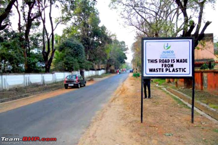

Originally Posted by ChiragM View Post
The first concrete road in India is said to have been built by the British in Chennai in 1914.
Today, we are seeing a lot of arterial roads converted from asphalt to concrete roads. Most driving enthusiasts prefer asphalt, but the government seems determined to convert as many roads as possible to concrete.
Asphalt also allows other materials to be incorporated into it, Difficult to do that with concrete. Almost 1 lakh km of road has already been built using plastic waste. Just the environmental benefits is a big enough reason to lean towards Asphalt.
