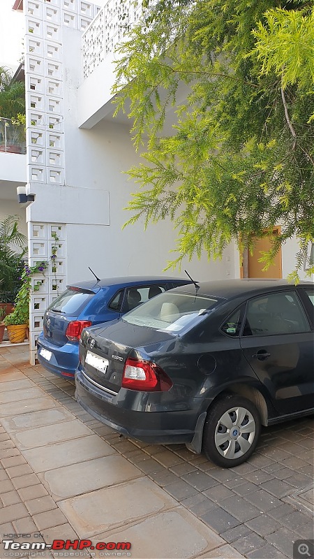

Thanks for all the suggestions. Here are the pictures. The first one shows that I need to cover an extension of ~5ft. The second picture to indicate the balcony height and possible support locations. The wind factor is definitely an issue and am wondering if the retractable awning structure will be able to manage given the size required. Somewhat closer to ~15ft x 5ft min.
Parking space too short - How to extend the protection for my cars?-20210528_074715.jpg
Parking space too short - How to extend the protection for my cars?-20210528_074701.jpg

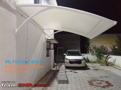

Retractable type is not good for this size and roof sheet (type I posted above) may look bad for your requirement.
Search for tensile roof structure vendors in your locality. That is the best solution for this size, height, and appearance requirement. They can mount the structure on the wall itself.
Parking space too short - How to extend the protection for my cars?-images-1.jpeg
Parking space too short - How to extend the protection for my cars?-images.jpeg

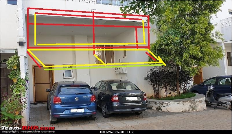

I am not a civil engineer. Just my two cents.
Option -1 :
The height of the balcony is a concern and there is a chance of front elevation getting affected.
Red - Metal Frame
Yellow - Sheets
Green - RWH collection and discharge.
Due to the height of the balcony, there is a chance of a decrease in incoming light to your main entrance.
Option - 2
If the sheet is protruded directly from the balcony frame then the sheet has to be extended much longer to cover a larger area. This may be slightly risky during windy season.
