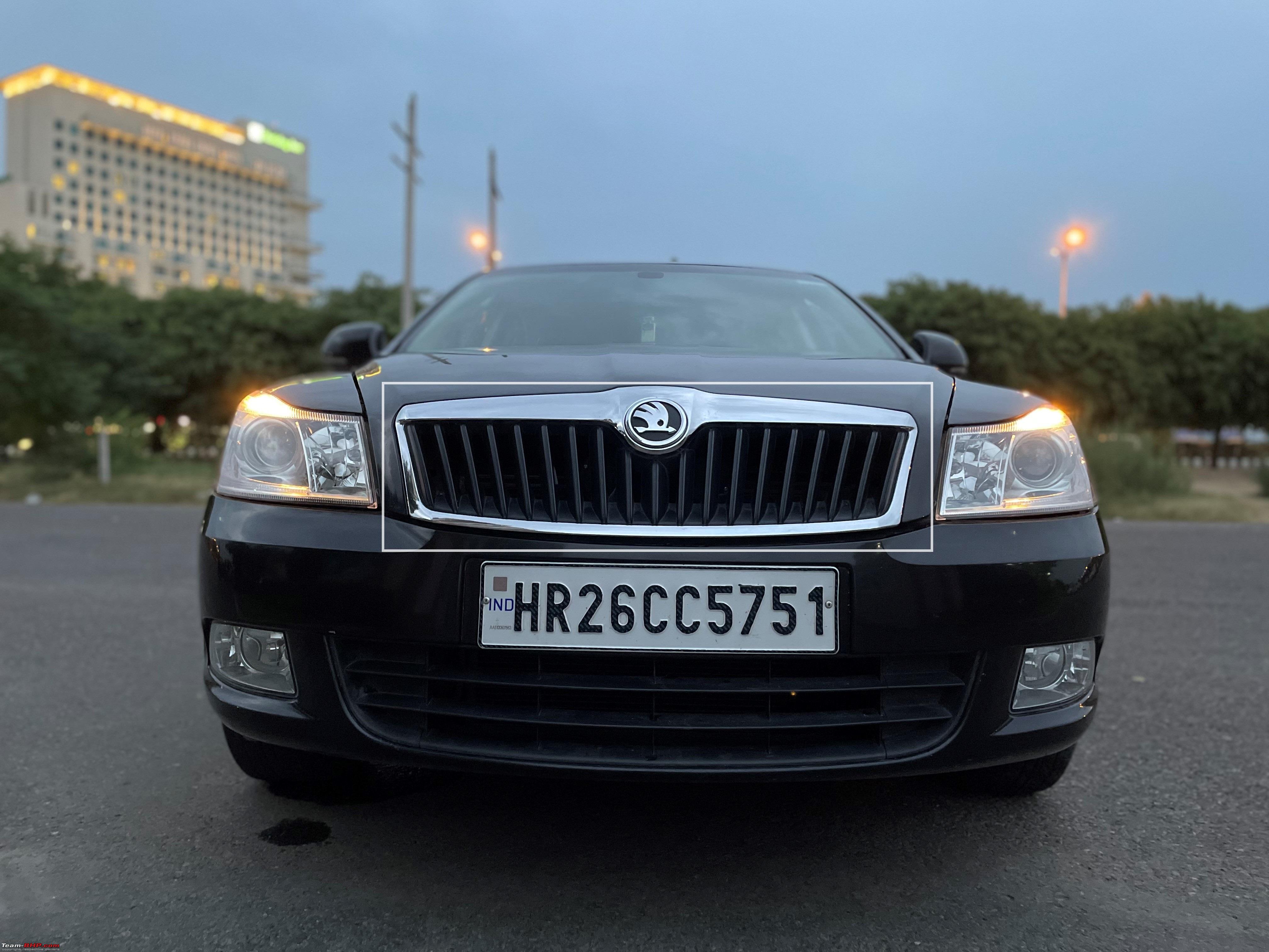

Hi Folks,
Pls suggest what would be the best way to get the front chrome-Grill painted in black, I am looking at some permanent solution. I have seen many cars with grill painted in black, but the paint starts chipping off in a few days time and looks very unpleasant.
I am ok either with paint or with wrap around the grill, highlighted below area is what I'm referring to.
Thanks !!
