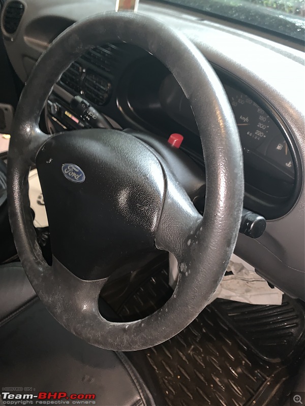

Today, I finally got the opportunity to open it, and to my horror, this is what I found:
1. The steering wheel has grown a lot of mould. The carpets have gotten damp and stinky. However, this is the least of my worries.

To add to my woes, the battery died and the hand brake got stuck due to humidity in the rear drums.
Lessons learnt:
1. Never park in a closed garage for a long while; the havoc that I speak of above took place only in a matter of 20 days.
2. Humidity is bad for your car. In the monsoons, keep driving every now and then, just to keep the brakes etc in good order. This only applies if your car is not a daily driver.
Currently, the car has been sprayed with liberal amounts of bug spray. It will soon be sent to the mechanic for a session of deep cleaning which would involve removal of the seats and carpets.

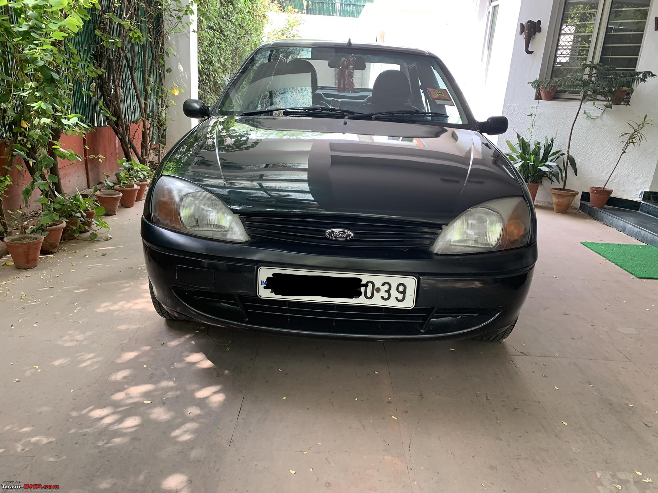

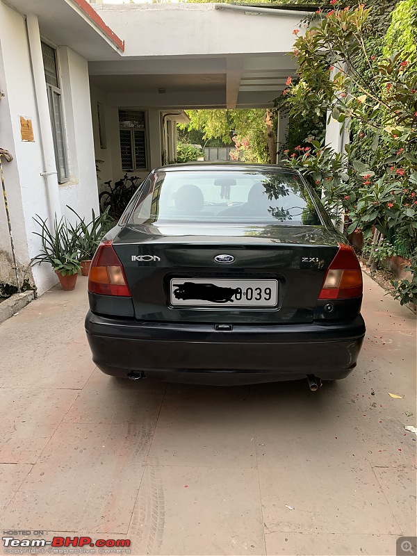

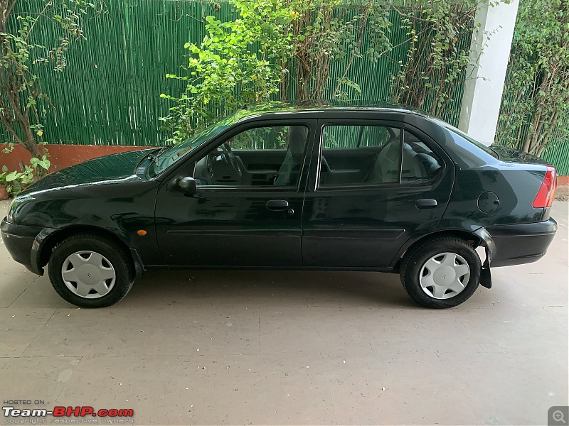

This is how the car looked just about 1.5 months ago. Seeing the car now, in such a sorry state really breaks my heart:
