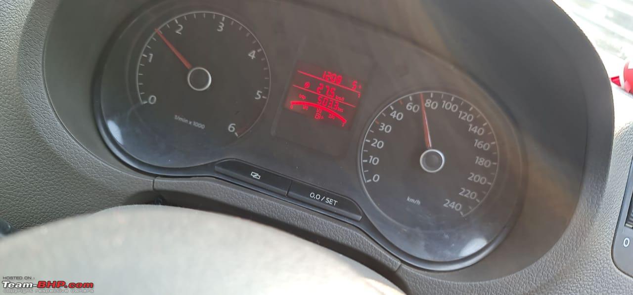

However, after the service, I witnessed drop in mileage in the vehicle. I thought of giving it some time for it to improve but after 2 months and 3000kms, it is still the same. When I say drop I mean the following:
1. Highway: My car used to give around 24-25km/L on highways, which had dropped to 19-21 now
2. City: Inside the city used to be around 15-17km/L which has dropped to 10-12 now.

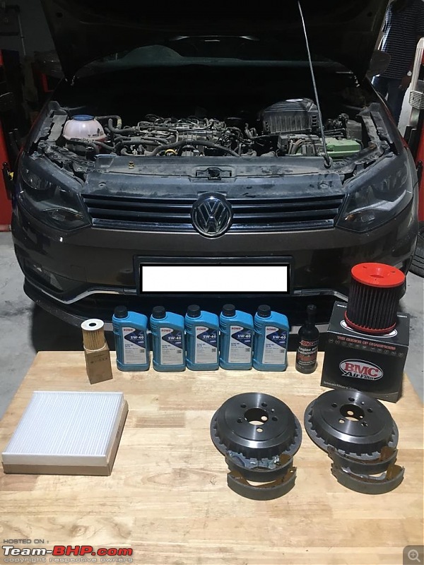

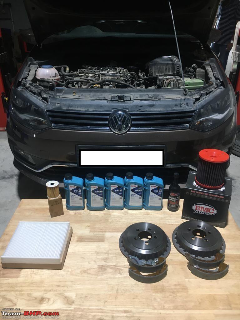

I got the below work done:
1. Engine Oil Change: Used Rowe 5W-40. Flushed with AMSOIL before filling the new oil.
2. Oil Filter: Changed with OEM one
3. Fuel Filter: Not changed
4. Air Filter: Since I got a new BMC filter installed at around 50k kms, just got it cleaned with compressed air.

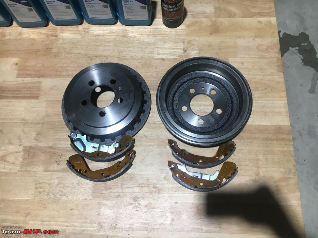

5. Rear Brakes: Got the drum and pads replaced
6. Cabin Filter: Changed with OEM one
One difference which I noticed was that VW service centre filled the engine oil till midway of the min and max mark and now the engine oil is at the max mark (not more).
Can someone help in identifying the reason for the drop? I am concerned if my engine is not getting damaged internally.
