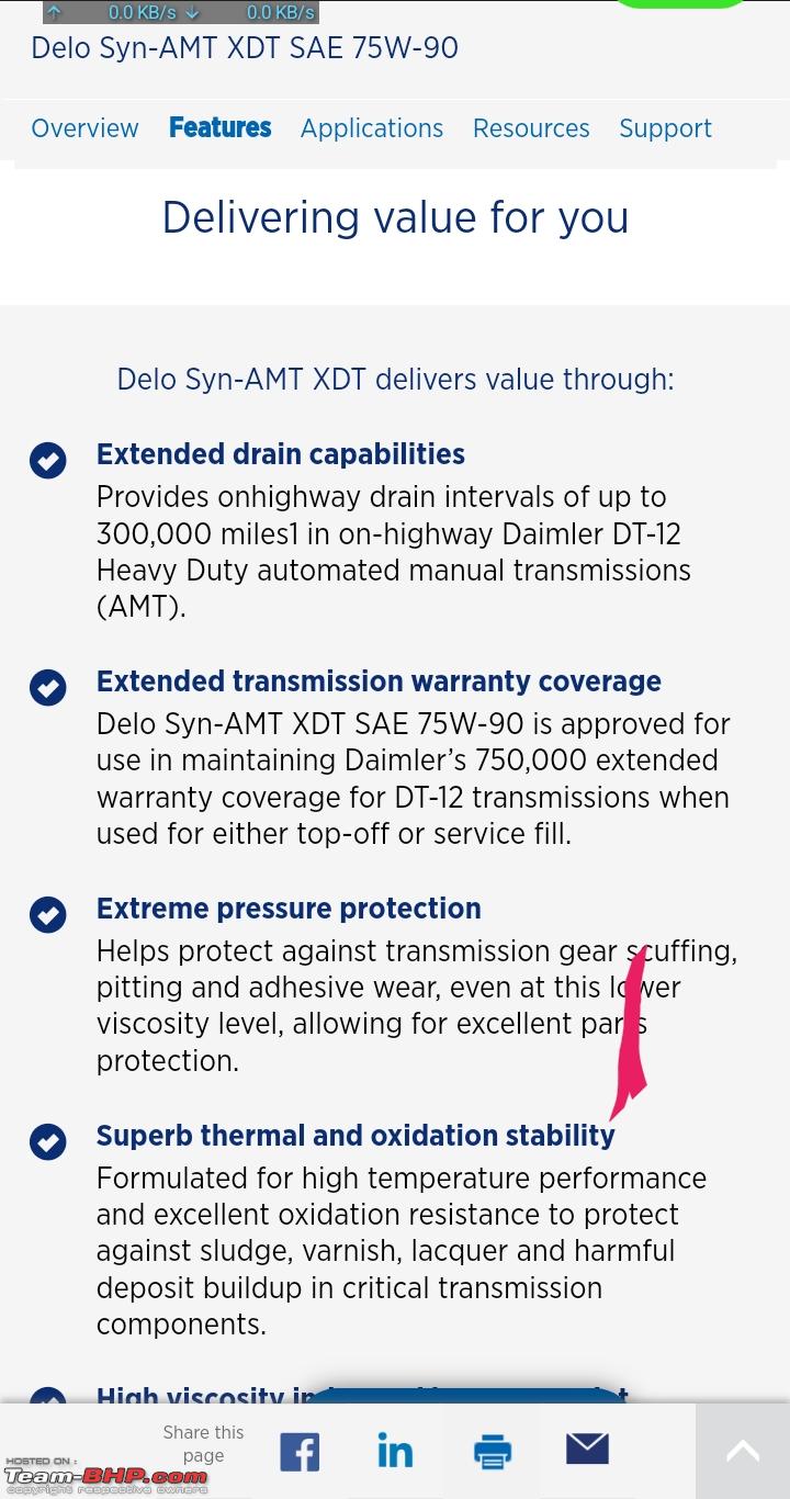

Re: Explained: How to repair a defective AMT gearbox
Today I attempted a change of the AMT oil on my Celerio. It has already done 58k kms and has been put to as much abuse as possible. Hence I wanted to experiment this.
Great DIY!
Only part I don't like is that expensive AMT fluid. I think you could use cheap gear oil for flushing out the system and then fill it with the "real" AMT fluid.
I found this:
https://www.chevronlubricants.com/en...ae-75w-90.html
Which means it is ordinary gear oil with extra additives.
By the way, which is the FNG you use?

I don't think it is gear oil at all. Actuator fluid is different from gear oil. AMT transmission oil is different from AMT actuator (hydraulic?) fluid. Not easy to find the specs!
https://www.ravenol.de/en/product/hy...actuator-fluid

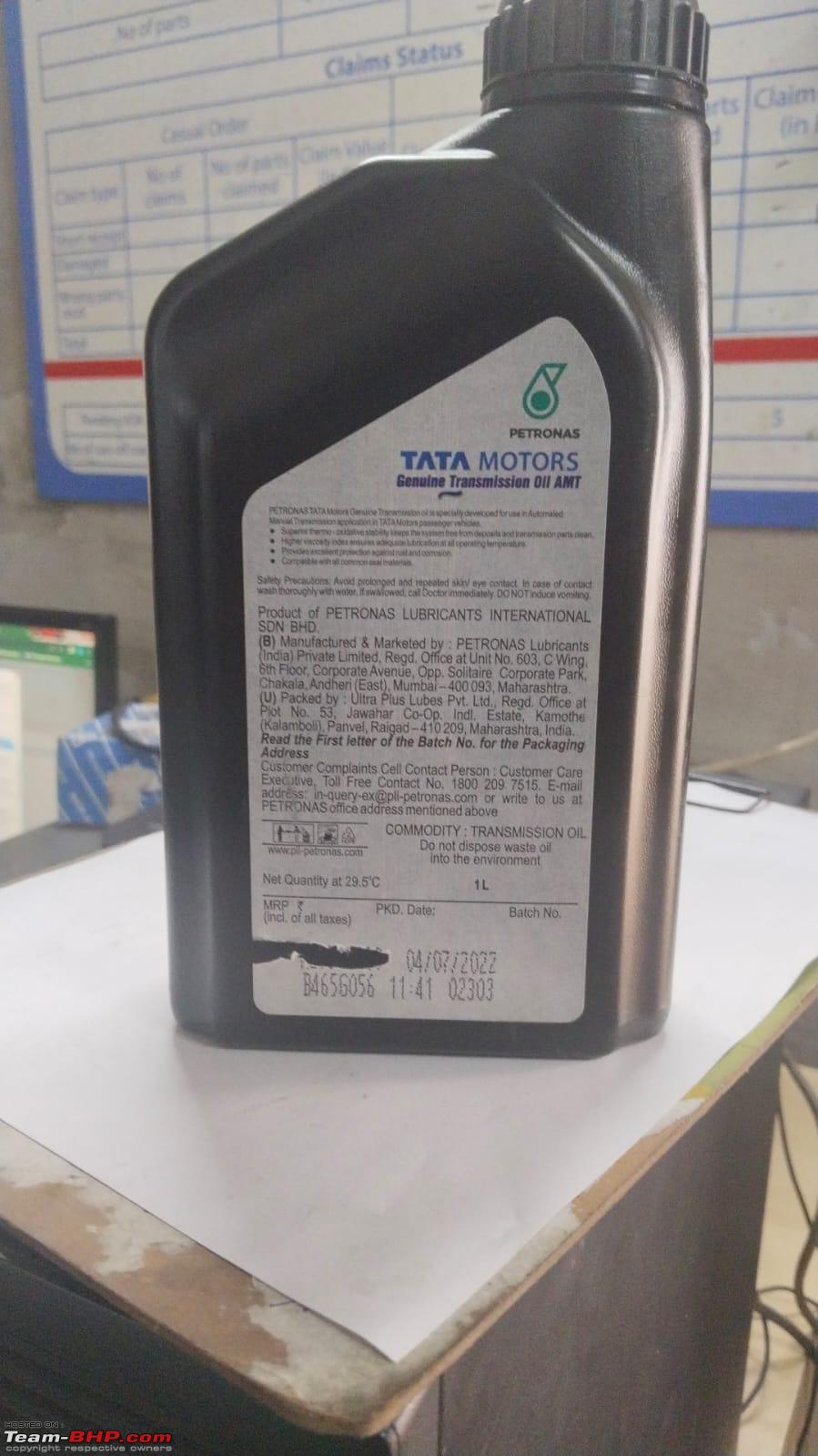

Old 22nd September 2023, 16:52   #30
lemedico's Avatar
Join Date: Aug 2013
Location: Agra, Cambridge
Posts: 774
Thanked: 2,452 Times
Yes, they do. Alternatively, get the part number and order it from Boodmo.
Tata Agra has sold this to me for ₹903. However, I am not convinced that this is AMT hydraulic fluid. It does t specifically say anything and the word transmission oil makes it seem dubious.
What do you suppose I do now?
