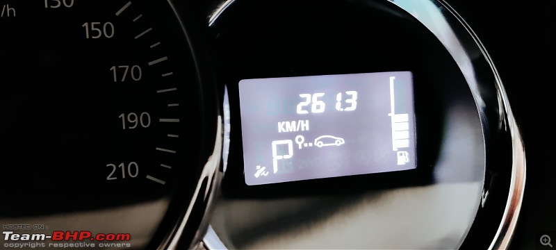

I own a Duster RXS CVT 2018 - 1.3 Turbo Petrol - which has been showing a weird problem since day 1. But as it happens, I stop, restart engine - it goes away.
The problem:
- Drive indicator "D" starts going on/off with a bizarre character (like "E")
- Electronic fault warning light comes on

Performance of Car (during this issue):
I generally stop the car within minutes. So, never had the opportunity to check the impact. But yesterday this happened again on my way from "AJC Bose Flyover" towards Airport via "Ma" flyover. Now, I didn't want to stop in the midst on the flyover - so I kept going, in fact pressed the paddle harder. While recording the video - I had slowed down at ~30, but later I went to ~70 & it was smooth & within 4-5 minutes I was out of the Flyovers & took a stop opposite to "Captain Bherry". As usual - as I restarted, all problems gone, I carried along for another 20 Km before I stopped for Garage. It never recurred.

This seems like one of the sensors on the CVT system misbehaving. Is there a particular condition in which this occurs? egs: Hard acceleration, climbing an incline etc? Try to find a way to replicate it to the service and that should help.

Unfortunately, the only commonalities that I could notice is:
  1. Starting the car after 2-3 days idle period.
  2. In all prior occurrences, it was extremely hot weather (had AC running at max capacity)
I reported this to Renault & they routed this to local service center (Vibrant Motors Barasat). They took the car this morning & spent all day to figure out any possible issue - but no luck yet!

Update 31st May 2022:
This problem has resurfaced on 29th May!
Same error, PRND Flashing along with the "Fault Light" showing up. Again had to recycle ignition to get rid of it. But this time, post restart - while the fault light & PRND went back to normalcy, "ABS" light came up permanently. Multiple restarts didn't do any good. I was heading for a close by Mall (CC2) - where I parked & went for lunch. I went back after almost 1-1.5 hours - started the engine, ABS showed up briefly, but voila - all ok! No more warning/errors on dash.
While I was driving with ABS on, I didn't rush - kept a low speed 25-30 kmph. So, not sure if I felt any lack of push/thrust or not - but later on, when I headed back home, all was normal (a test speed for a few seconds at 80-90 was smooth).
Informed "Vibrant Motors" Barasat and they again took the car to their workshop yesterday (30th May). They are apparently collecting all data & will share with Renault & expected to give me an ETA by today.
