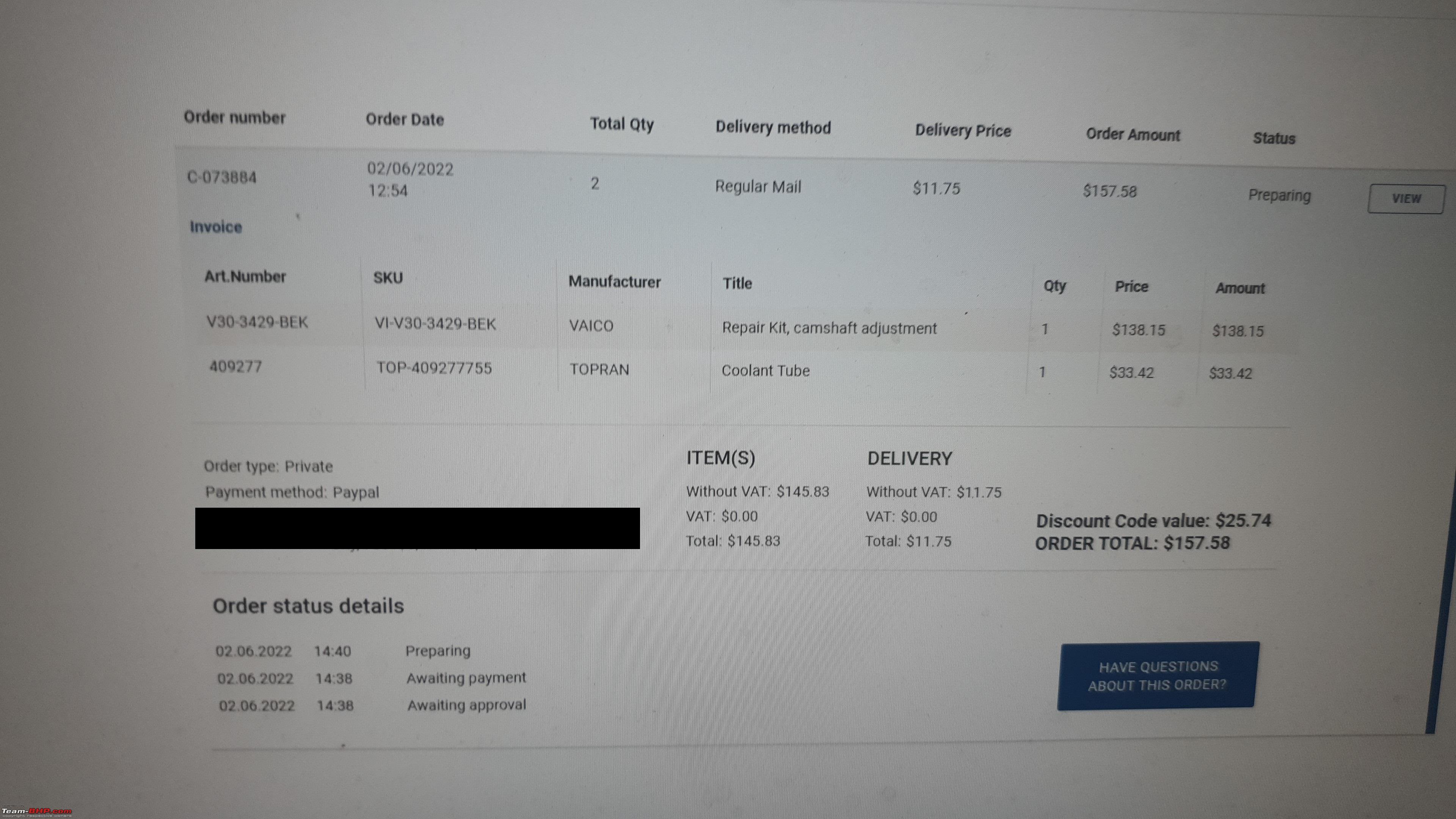

Got the car scanned using a Professional Launch Scanner and did alot of research across youtube and Mercedes forums. Turns out it is the 2 camshaft magnets in the front of the engine. They basically connect to the camshaft position sensor and are a known problem on the m271.
These needs to be replaced every 50k-60k Kms as per my research. My car has done just upwards of 52k Kms plus on close inspection of the magnets, they do look faulty and are definitely slowly but surely leaking oil. This leak in the longer run damages the harness and also the ECU if left untreated.
I got an unbelievable deal on the entire Cam Magnet Kit made by Vaico. I also ordered a replacement Coolant tube as the one on my car leaks (another known m271 issue)
Both these items cost me about US$157 inclusive shipping.
I have attached a few images to this post for your reference.
The lead time on the order is 15 business days for it to ship. Ordered from cars245.com and these will ship from Latvia,
Will keep you guys posted on further developments once the parts have arrived, which a week after ordering feels like forever :(
