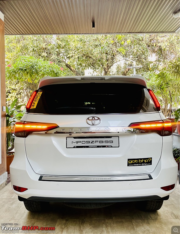

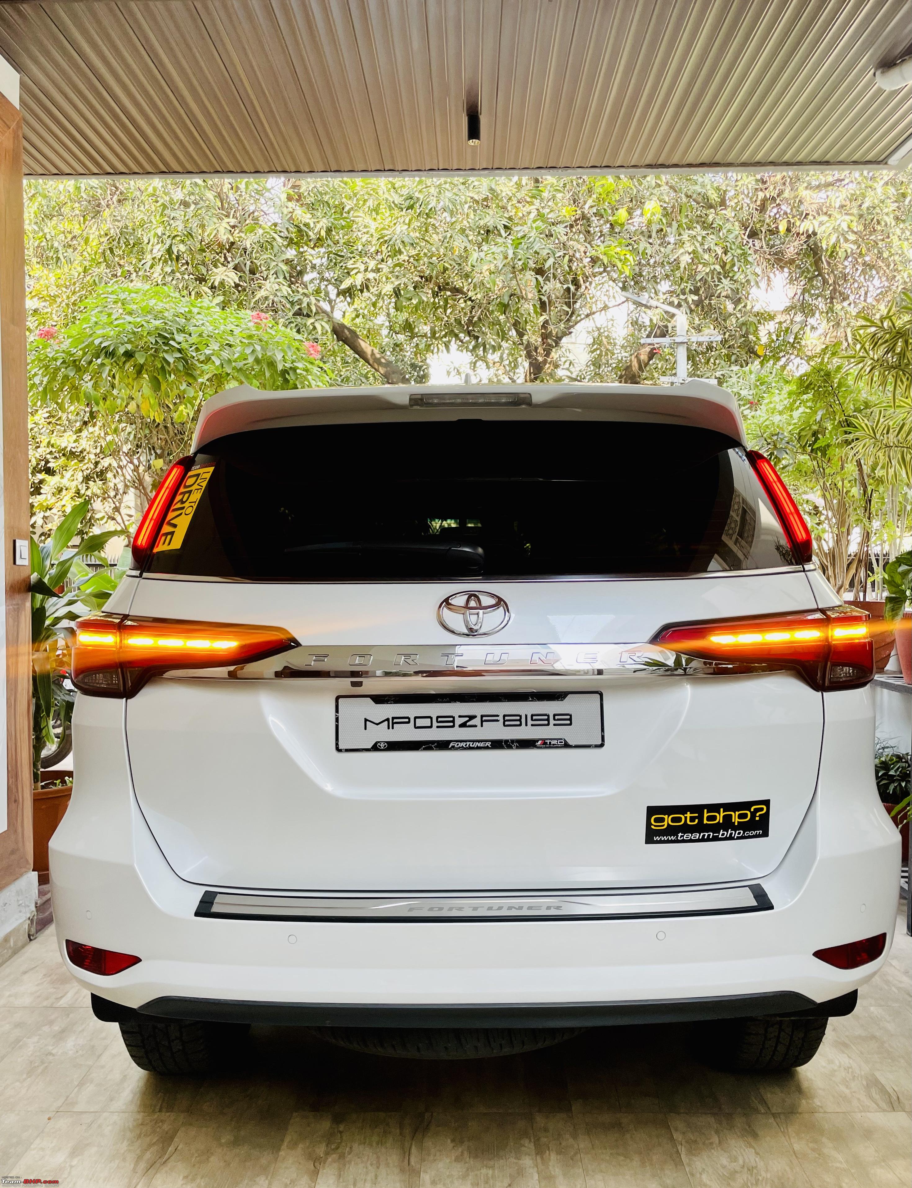

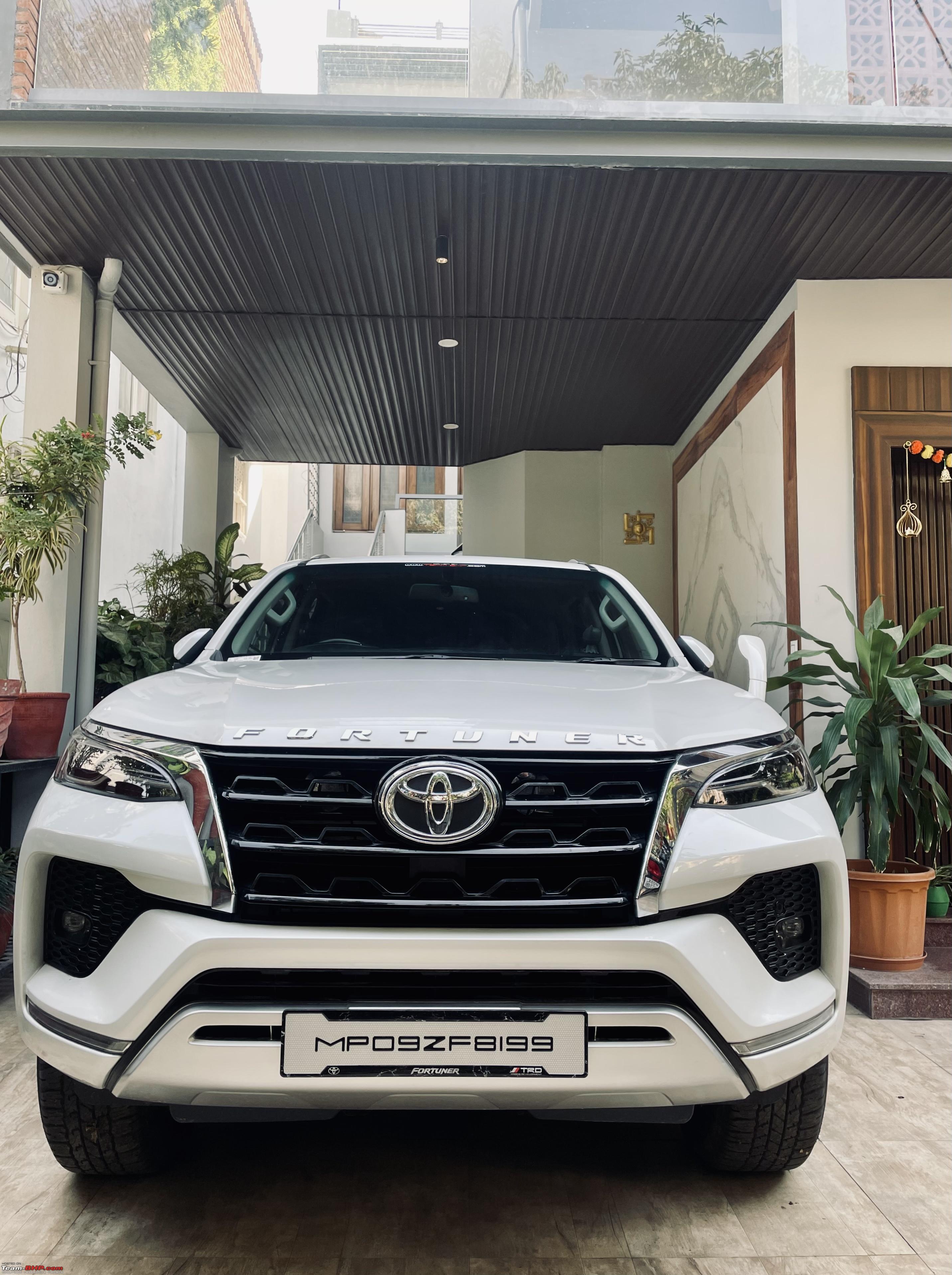

Last month 31st I got delivery of my fortuner AT (D) from Anant Toyota, Indore. Further if any help is needed do PM me.
