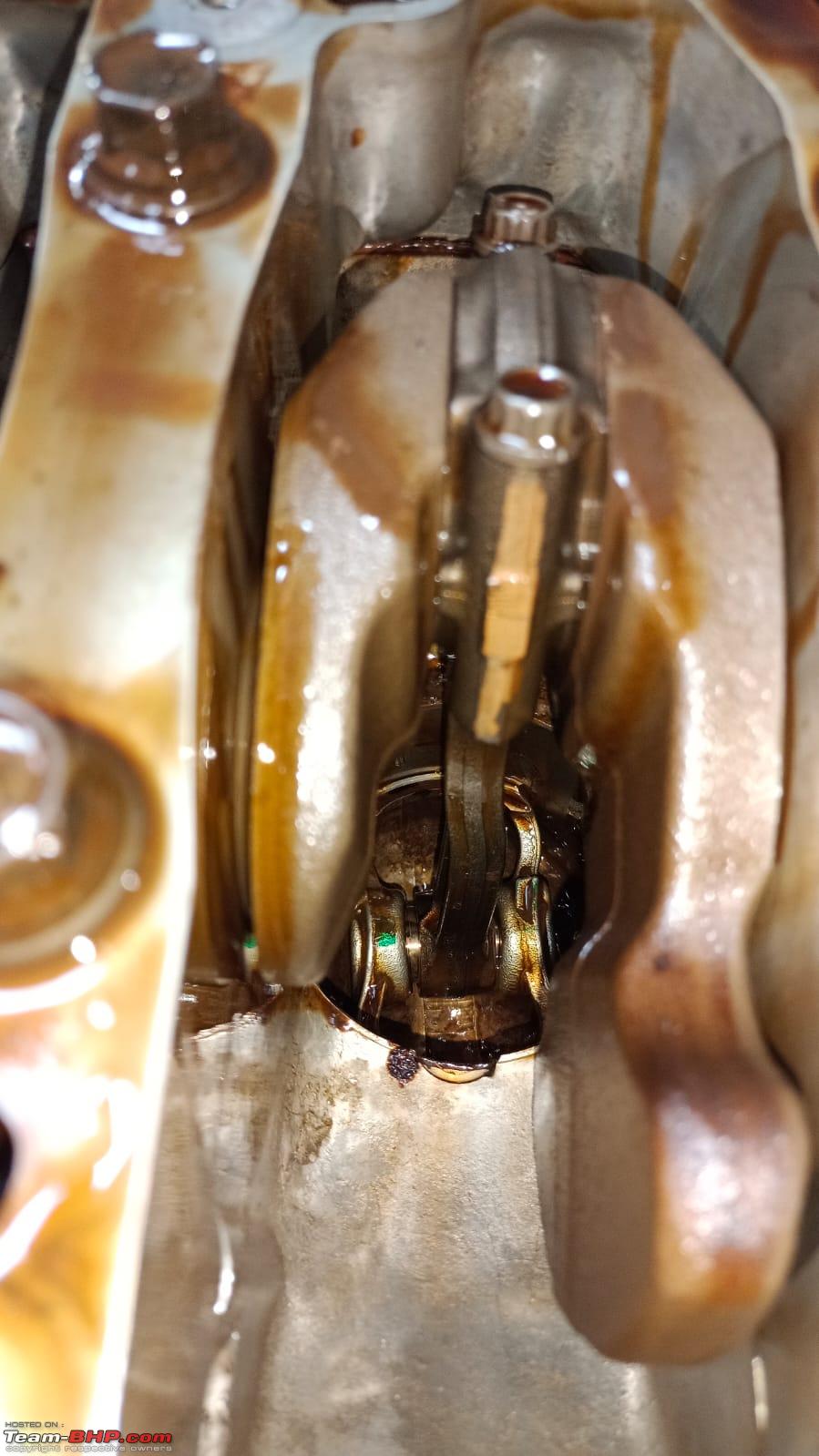

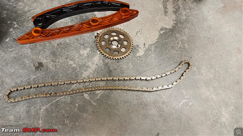

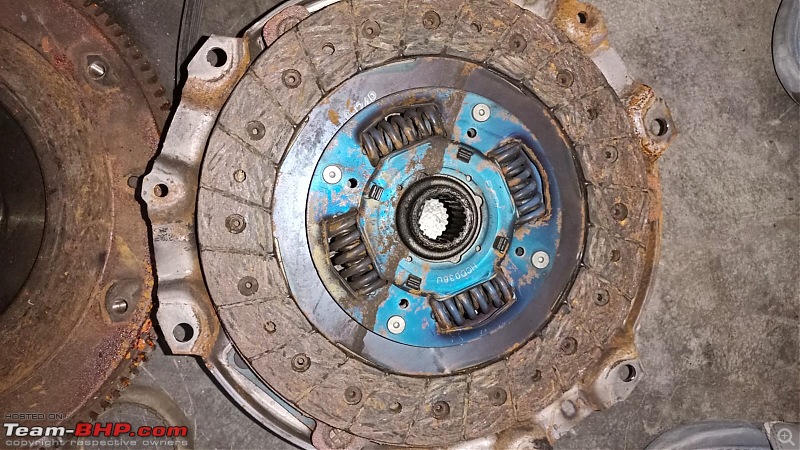

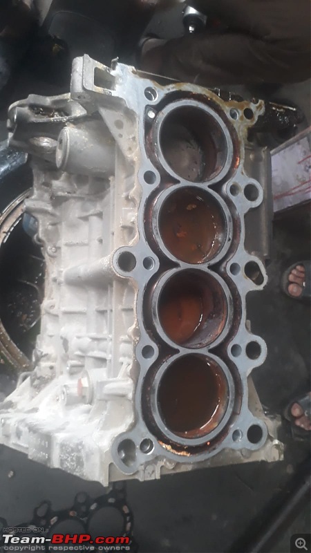

Hi all,
The recent heavy rains in Bangalore and poor condition of the roads and the drainage resulted in my Honda Civic sucking up water. A bus moving through the road, created a mini wave and my car managed to suck up water through the intake. Ofcourse, it stalled after that. Water got into the cabin.
This is a 2008 model and now I'm given an estimate of 1.55 lakh for repairs. With 50k for the engine overhauling itself. The car has done 80k+ kms so far. I have insurance that does cover natural calamity including flooding. I think they provide 50% coverage for parts provided there is a GST bill. I know for sure there will be no GST bill for engine overhauling and maybe many others as well (perhaps most items under Machine room and outside works in the bill below).
Alternator is jammed, so is the starter motor. I have included some pictures to show you the state of the engine and the clutch plate. Clutch plate is actually new and hasn't done even 3k kms.
Looking for some expert opinion on these matters:
1. How reasonable is the estimate?
2. Engine overhaul or find an engine from a scrapped or totaled vehicle?
3. Insurance has sent a long questionnaire, knowing how insurance companies are and trying every reason to reject. Could someone PM and assist me how to approach filling the questionnaire?
4. I feel the cost to fix jammed alternator, AC compressor is on the high side.
5. Any suggestions on which garage in Bangalore would do a good job at a reasonable price?
6. Any contacts in Bangalore that does engine overhaul or will be able to provide an engine from a scrapped car?
Appreciate your inputs. Thank you in advance.

If your engine seized up I dont see any estimate for Valves or piston or rings etc which are the usual victims of seizure. May I ask what was the diagnostics for the seizure like broken cam, bent/broken valves, bent/broken piston, Crank failure? Or simple ingress of water and choking the engine?
If your Engine has choked and hasn't damaged the above mentioned parts, then I think you just need to get Head of the engine resurfaced and pistons cleaned and injectors serviced, engine flushed with oil and then try starting the car, then check the electricals and it should be good again.
Nehow The estimate seems a bit high and vague. I just feel after looking at the labor Machine room and Outside work charges that your engine simply choked on water and the sensors killed the engine. and also was your power steering pump damaged?
Honda power steering pumps are quite durable and hard to fix, until unless there was ingress of water in it through the power steering rack, I wouldn't touch it. And also was your radiator damaged? I see alot of charges for hose pipes and coolant related stuff which i think you are getting replaced due to aging and not damage.
