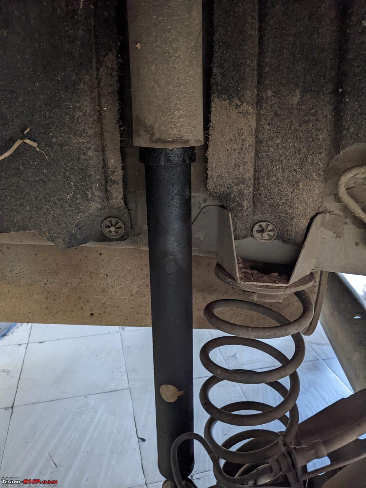

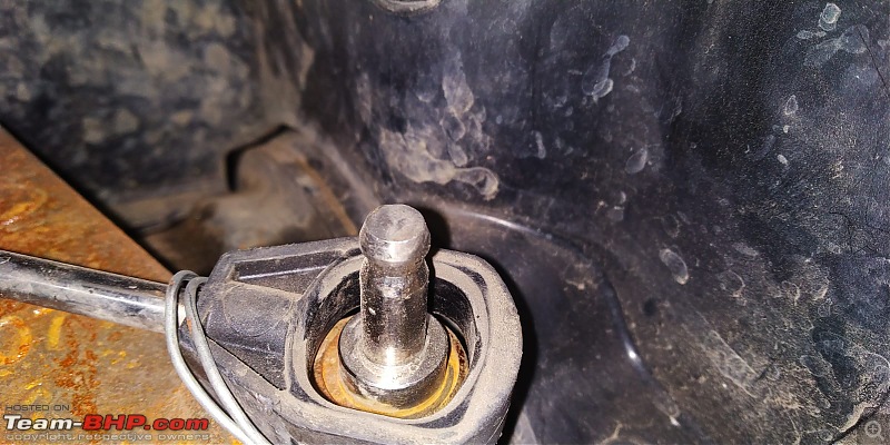

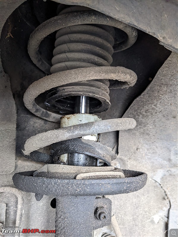

3. Also, based on the pictures, how bad is the shock does it need an immediate replacement or can it be changed

I could make our something regarding an A/C belt from the pictures too, which may need attention if you're experiencing any issues with operation. But a typed list of items on the job card will really help us give you better feedback.

1. Your cars shock absorbers definitely look gone. Both the photos show oil leak. You should replace.

The shock absorbers are definitely gone. It makes sense to change the strut mounts and bearing as well. Rear , just shocks are sufficient.

a. If the shocks are in bad condition, it would have resulted in damage to lower arm - ball joint. Need to check that also; replacing the shocks when the ball joints are worn out / damaged will cause damage to the new shocks as well.
b. The above would have also resulted in uneven tyre wear. That too needs to be checked. If you plan to keep the car for 5 years, you need to have good tyres.

Looking at some of the Pics, the gear shift bush has to be replaced and Ford doesn't only replace the bush ,they ask to change the whole cable assembly that costs almost 13k. My fiesta too suffers from this but i have a temp juggad fix(Like yours) and will get the bush replaced from a FNG at the next service. A similar situation occurred with my aunts 2014 ecoboost ecosport and ford asked to change the entire assembly, a FNG just replaced the bush(better quality plastic that they claim will outlast the rubber one), no sweat, so i assume it should be fine with this fiesta that shares the same IB5 gear box.
