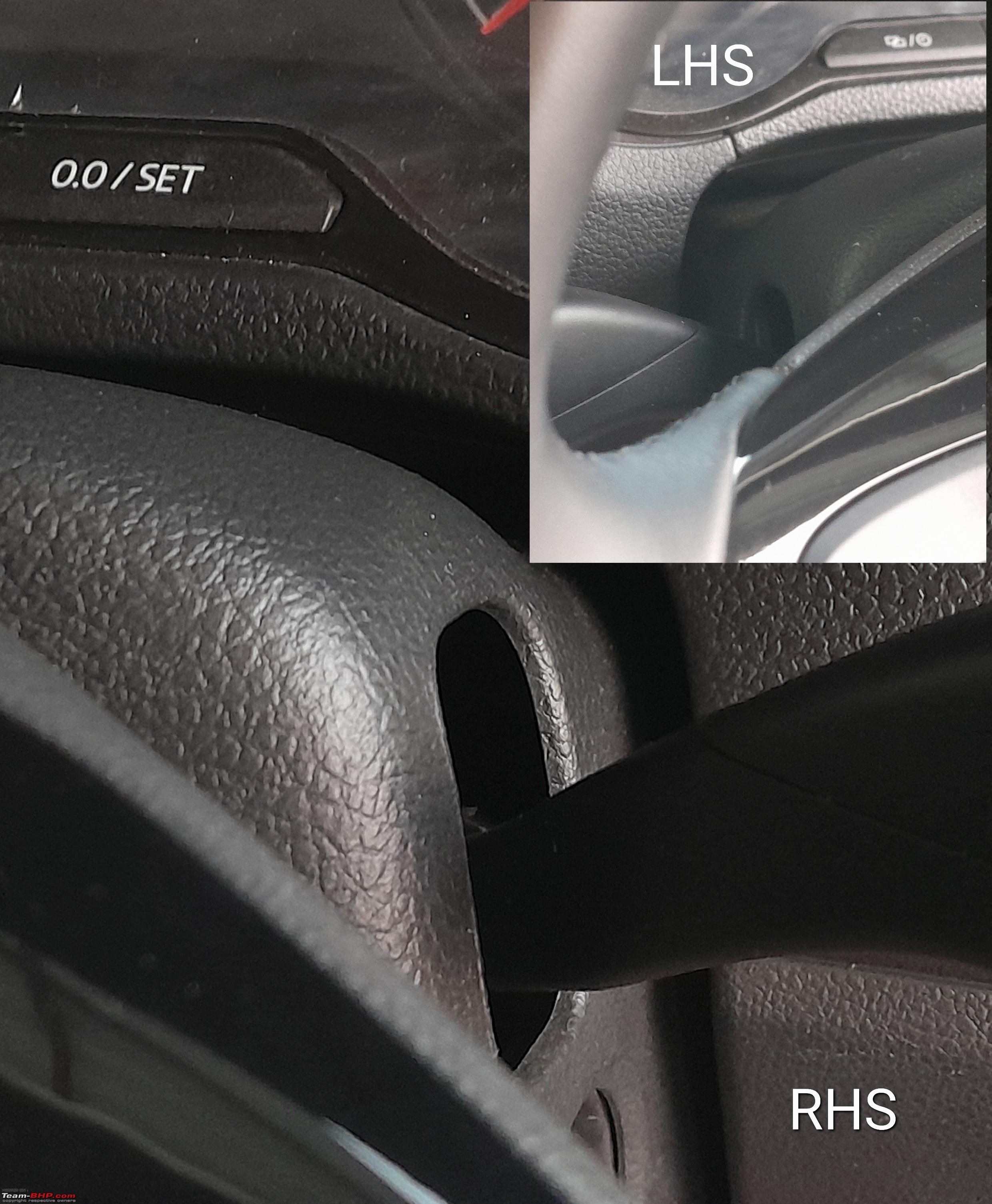

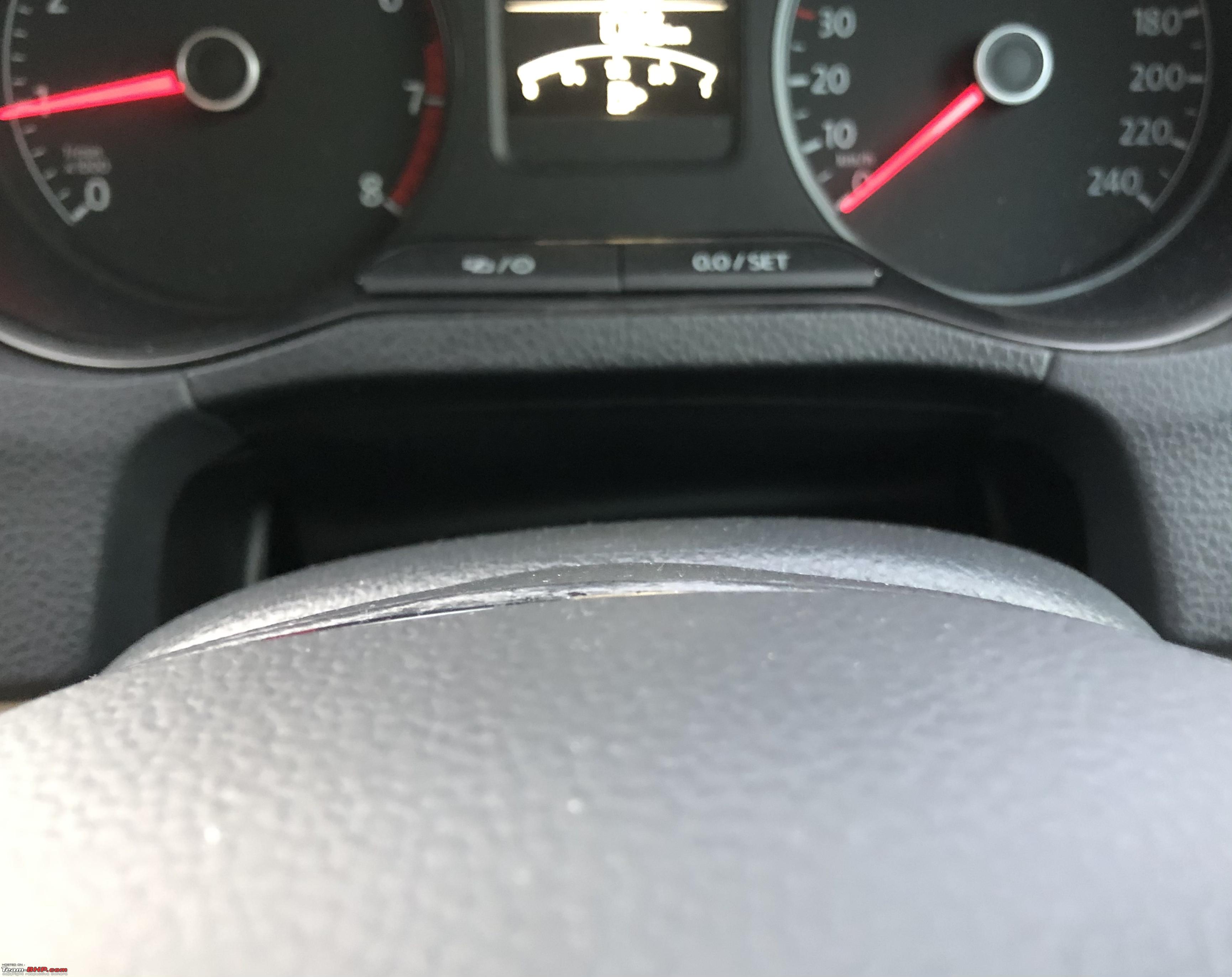

2. The Steering Column outer cover is fixed tilted to the left. The Indicator & Wiper assembly is also fixed tilted to the left.
My Thoughts - The lower steering column cover (picture attached for reference) is held at its place by a ‘Socket Head Collared Bolt’ screwed to the “Ignition Switch Lock Cylinder” and the upper column cover clicks onto the lower cover. The lock cylinder & the indicator stalk assembly slide onto the steering column. So, I suspect if the steering column itself is fixed tilted because all the parts which slide onto it are slightly tilted and not accurately fixed. This gives an illusion of driving with an incorrect steering position, unaligned with the column cover and is also an eyesore and a great distraction.
Quality lapses & fit/finish issues in my brand new VW Vento TSI AT-tilted-column-cover.-jpeg.jpg
Quality lapses & fit/finish issues in my brand new VW Vento TSI AT-tilted-stalk-assembly.-jpeg.jpg
Quality lapses & fit/finish issues in my brand new VW Vento TSI AT-steering-column-cover.-jpeg.jpeg

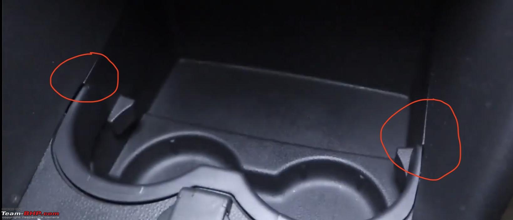

6. Improper finishing with sharp edges in the cabin, near the front cupholders.
Quality lapses & fit/finish issues in my brand new VW Vento TSI AT-bad-cabin-finish-.jpg
Attachment 2350957
Attachment 2350958
Hi, congratulations on the new car!
As for the misalignment of stalks, I have observed the same in my Polo (MY'22). What I've seen is that the stalks are purposely misaligned. As seen in the photo below:
Quality lapses & fit/finish issues in my brand new VW Vento TSI AT-20220918_1802402.jpg
The cutout for LHS stalk, by design, is placed a little lower than the RHS stalk. My guess would be to keep the left stalk within the reach of left hand when it is in its most upwards position. And yes, the whole column is tilted to the left in my Polo too but it never caught my attention. The best you could do is live with it and enjoy the drive. Good luck

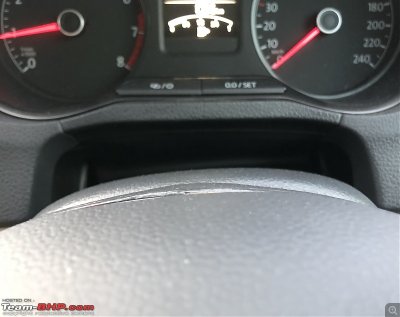

Attachment 2350958
Hi, I have a 2022 model Polo with rain sensing wipers function. By any chance, are the right side stalks set to the auto mode? If that's the case, there will be this misalignment between the left and right stalks. Set it to the "off" position and check if the stalks are at the same level. If not, then there is an alignment issue.
When checking for steering alignment issue, I'd much rather believe the tire alignment report than comparing it to other elements on the dash. In the end all that matters is whether the steering and the tires are aligned properly. Of course, if the dash elements are misaligned, they can be an eyesore but that can be easily corrected.
