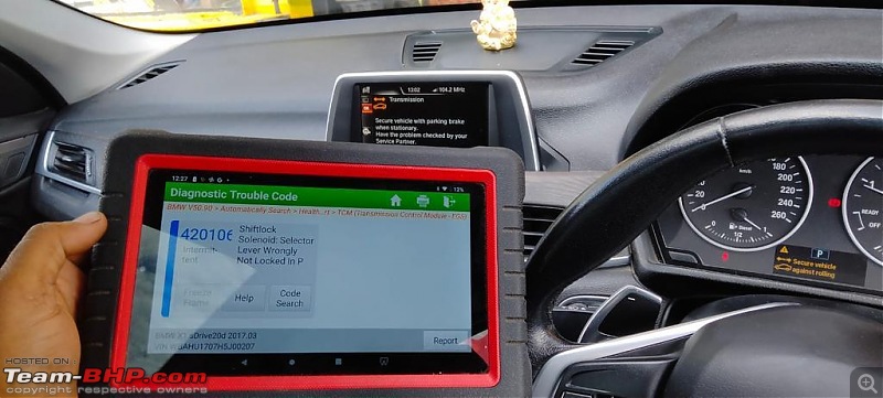

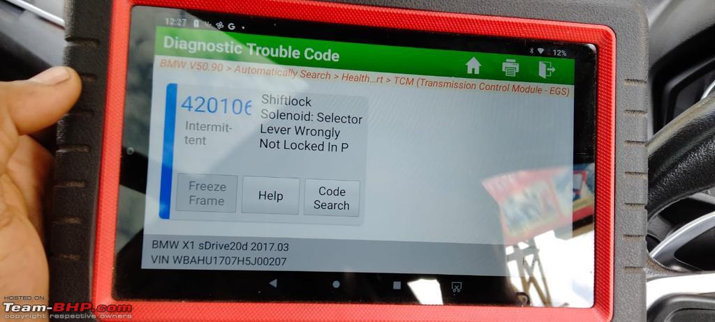

Got the error scanned and here is what we got. Shiftlock Solenoid : Selector lever wrongly not parked in P.
Quick read on internet says it’s a problem with spring. It’s 2017 model and out of warranty.

No symptoms as such. Just get this message when put in parking. I got this scanned and it’s says Shiftlock Solenoid : Selector lever not wrongly locked in P. Quick read on the Internet tells me it’s a common problem in BMW.
