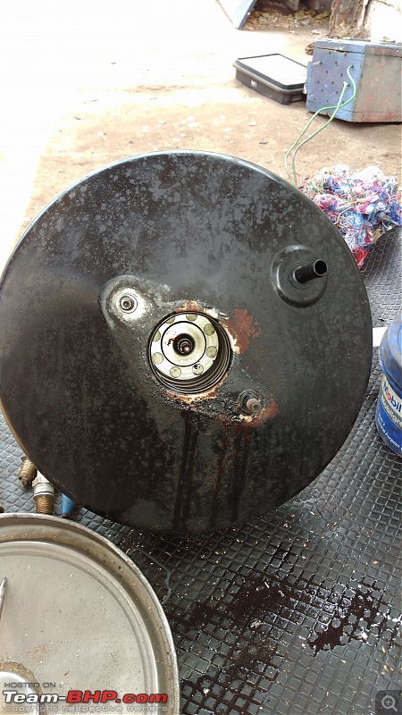

Let me now elucidate in detail , what required the change of the 'Brake Master Cylinder':
Its been months now that I have been facing this peculiar issue : The brake comes into effect only when the brake pedal is pressed sufficiently. For example, for the initial press of the 'Brake pedal' , nothing happens. Lets say, that the 'brake pedal travel' is being measured on a scale of 1-10. For the initial '1-4' brake press , nothing happens. Brake comes into effect between '5-10' on the scale. I keep on topping up 'Brake fluid reservoir'. Initially, I went to the same workshop which recently attempted the part replacement (WoS, Noida). There the mechanic and SA mentioned 'Brake Master Cylinder' being the culprit. I got the same diagnosis from another workshop. I have checked some YouTube videos and they confirm the fact that its the 'Brake Master Cylinder'. Therefore, when I went to the independent workshop , I had procured the AFM Brake Master Cylinder. However, what can we do if the originally one is stuck and wont come out?
This is where I need advise from fellow T-BHPian's:
What can we do IF we are unable to replace 'Brake Master Cylinder' as it seems to be stuck to the 'Brake Booster'?
I would like to inform all, that we have already done the brake bleed and it makes marginal difference to the issue. According to the SA and mechanic , if they force the part out , it would not only damage the original 'Brake Master cylinder' --This is something that I can allow, as I already have the replacement-- But it would damage the brake booster as well. This is what I fear. That is the reason we aborted the replacement. But then I am stuck with the same issue.
My constant fear is: If they force the part out albeit damaged and then on top of that the brake booster has incurred damage as well. Then I may have to get the Brake Booster replaced as well.
Lets continue with the same line of thought and we decide to replace both. What guarantee that the original brake booster wont cause the same problem that the 'Brake Master cylinder' is causing. The problem: unable to remove it. Then I will be stuck and would have no where to go. This is where I need fellow T-BHPian's advise.

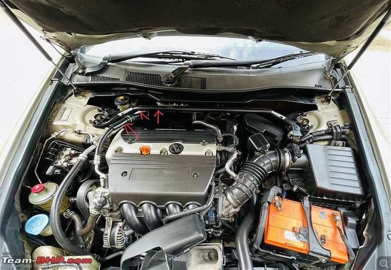

1. I presume you've inspected the brake network and confirmed that there are no leaks - ABS Unit (please run your fingers at the bottom and check for leaks), brake hoses, joints, disc brake pistons, rear brake system
2. If you're needing to top up brake fluid every now and then, and you've checked that there is no leak in the brake system, then the brake fluid is leaking past the o-ring inside the tandem master cylinder (TMC) into the brake booster.
To remove the brake booster and TMC as one unit here is what can be done:
1. Remove the strut bar connecting the two strut aprons (marked in the attached pic below)
2. See if this gives one enough room to pull the Booster and the TMC out
3. If not, you will have to recover the refrigerant and disconnect the power steering hose and the AC Compressor suction hose (marked in red) to create that opening
4. Disconnect the brake pedal connection to the booster and the 4 bolts mounting the booster assembly to the engine firewall (body of the car)
5. Remove the booster assembly and then try to remove the TMC
It is likely that the booster has accumulated some brake fluid. If yes, that will need to be cleaned out only using a suitable solvent (service technicians would know best). If there is no other leak in the brake system and it is confirmed that the TMC is the only one that is leaking, your system will start working well after TMC replacement. If you find the booster damaged/corroded inside, please have it changed too. Getting a good booster - TMC from the used parts market will also do.

I have to top up brake fluid every 700 to 1000 km. The amount added is not more than 10 ml. I presume brake fluid is leaking into Brake Booster. There is a hose inlet on top right of the brake booster. The mechanic unplugged that hose. Seems vacuum line or something. When he unplugged the hose, he inserted a thin metal line or something in the inlet on top right of brake booster, not in the hose. When he pulled that thin line, he identified brake fluid on it.
I am of the same opinion that booster has accumulated some fluid. I have already ordered OEM Brake Booster from boodmo. Hoping they will fulfill this order.

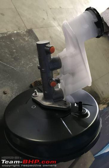

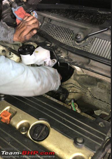

Day before yesterday, took some time to get the car to the repair shop in order to get the pending replacement job done. The OEM brake booster, brake master cylinder, and OEM Dot-3 brake fluid had arrived and been lying dust at my home. The job of detaching the old brake master cylinder from brake booster and getting brake booster out from the engine bay in itself required two to three hours. There wasn't enough space to get the brake booster out, the mechanic had to get the AC line out which lead to the release of any existing AC gas in the system, the strut bar had to be removed, we didn't remove the power steering hose as stated by fellow Bhpian 'vigsom'. However his advise was really helpful in terms of getting the job done.
Once the old parts were out, getting the new brake booster installed was time consuming. The replacement job started at 1145 and by 4 PM we had the old parts out and the new brake booster installed. Then the new brake master cylinder was installed and filled with OEM brake fluid. The peripheral parts taken out to get the space required for the brake booster were re-installed, AC gas refilled, then started the final phase of brake bleeding and test drove the vehicle to check everything was in order.
I have driven the vehicle for 100 KM's since the job was done and the braking is working fine.
