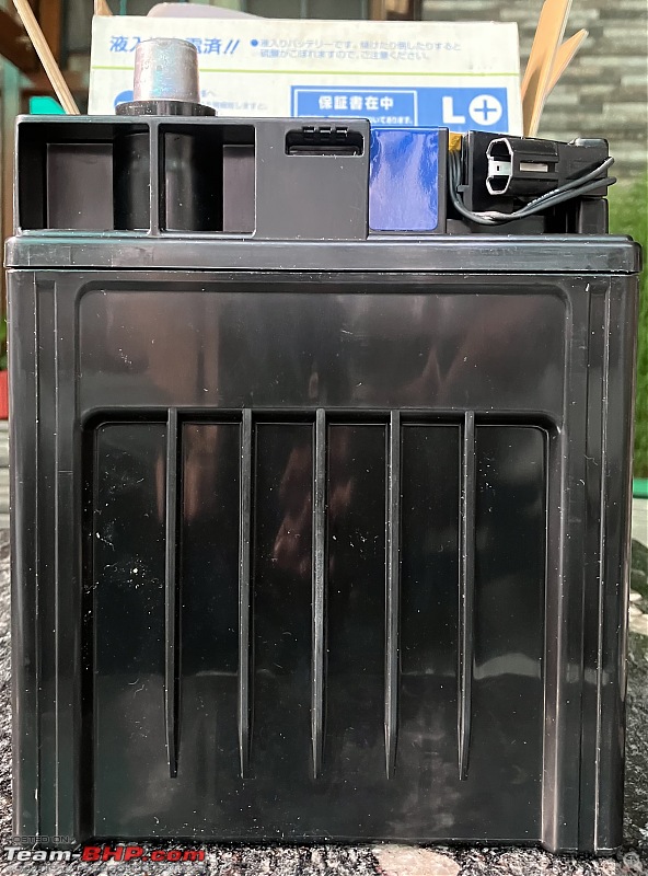

This is in continuation to my last post in November 22 on failure & non availability of 12v battery of Lexus RX 450hL. So 5-6 months have passed with no solution from Lexus India. Thanks to members who were so helpful in finding some solution. However since nothing much transpired in between, I did not post anything in this forum.
Initially I got call from Workshop Manager of MGF Toyota Lexus, Peeragarhi stating the price of OEM Panasonic 12v battery is Rs 1,03,660/- He asked that if I am interested it can be shipped from their Bangalore store.
So I asked him about manufacturing date of new battery available with them & also if they can suggest an alternative battery which would be available in India. I also requested to give a service battery for the time being which they denied.
In reply to above queries he informed that they have only one battery available in stock & it’s manufacturing date is around 2-3 years old. Warranty just for one year. Imagine buying a 12v battery for more than a lakh, with just one year warranty & also 2-3 years old product.
For alternative battery I was asked to provide dimensions of existing battery which was required by Lexus India. Surprisingly Lexus India did not even have specs available with them. Happily I gave him specs & dimensions by drawing a proper diagram of battery & sent it to Workshop Manager hoping to get some solution for an alternate battery. Months passed but no response. Then one fine day he informed that Lexus India has advised to buy same battery as they do not have any alternative. They are ready to import new battery but would not know how old it would be. They would know its manufacturing date once it arrives. Of course payment to be made in advance. Seeing all this I dropped the idea of getting from them.

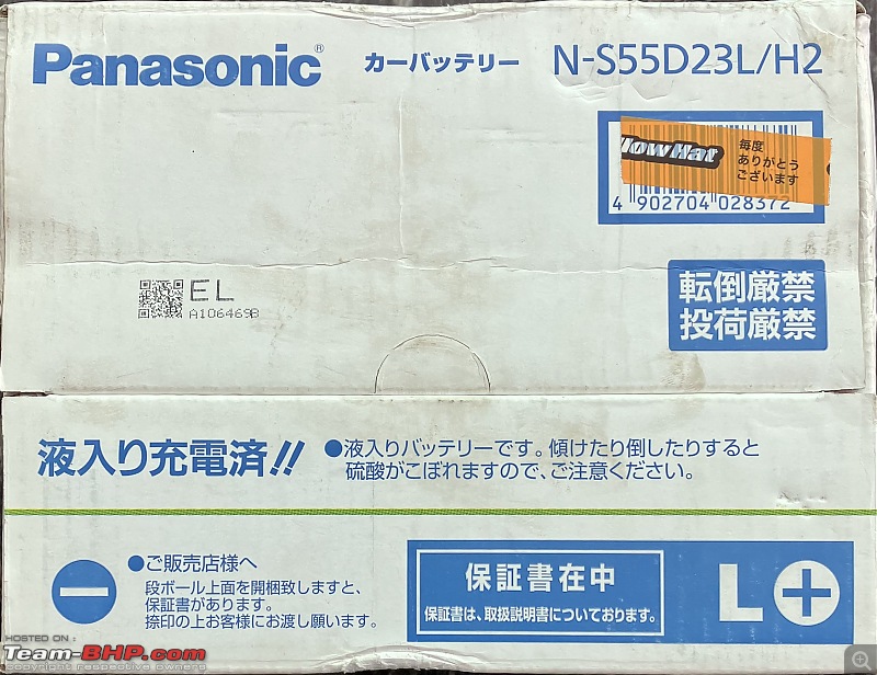

So finally managed to locate battery last month in Japan & bought it. It is a 12v Panasonic CAOS Blue Battery S55D23L, type H2 which is made specifically for Hybrid vehicles. These batteries have inbuilt temperature sensor which adjusts the charge voltage based on actual battery temperature. It is a safety feature to control overheating of battery. Costed around Rs 30,000. It did take some time to bring it to India. It comes with 3 years warranty. Same battery Lexus India is selling for one lakh plus with a years warranty.
