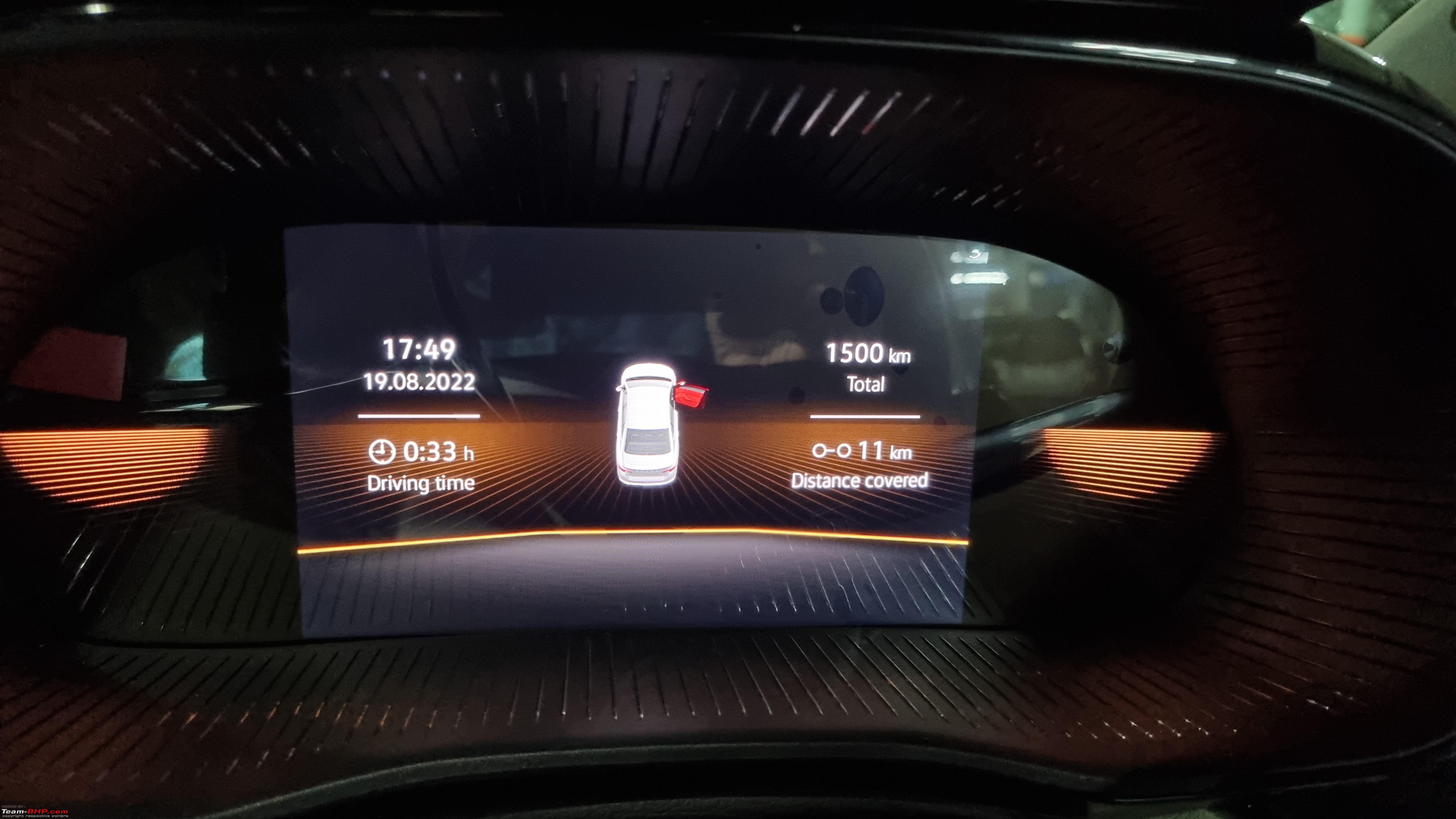

The 2-cylinder mode (or Eco Mode) is really a nice thing. It really improves fuel efficiency & is a boon in moving city traffic; I keenly watch the mileage.
1500 kms done on Janmashtami. I am waiting to reach the 2k milestone to unleash this beast
VCDS tweaks for Skoda / Volkswagen MQB A0 IN platform cars-20220819_174925.jpg
