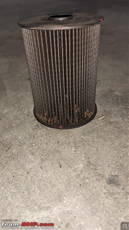

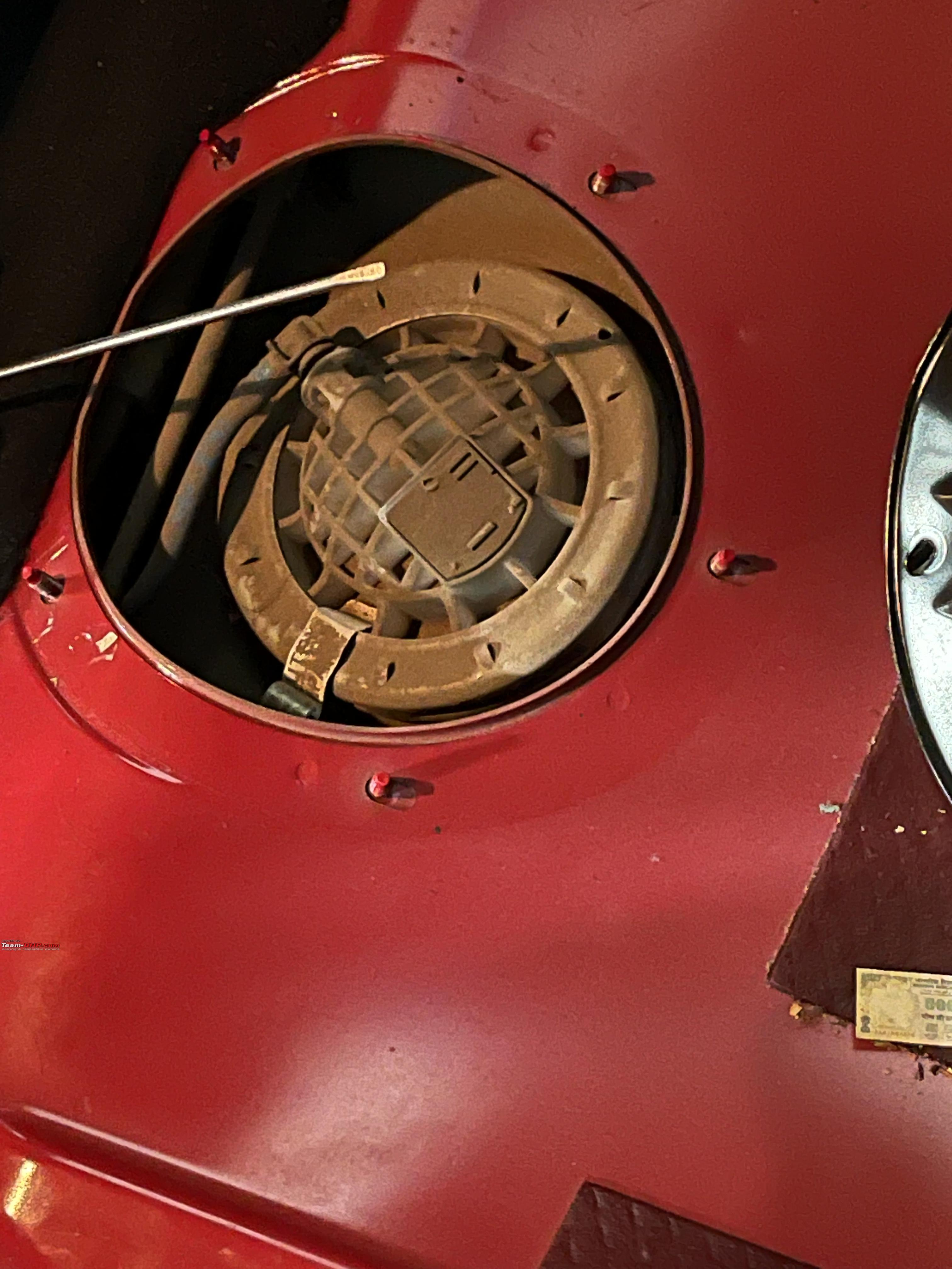

Basis my experience with this kind of problem (in a petrol engine), here is a suggestion.
Drain the tank and remove and examine the fuel filter and change that. Im sure it is dirty considering the levels of fuel adulteration that we see in India. Ask the garage to remove the fuel injectors and have them cleaned. There is a cleaning process possible. Ive done it. Take the opportunity to drain and change engine oil and change the filter too. Then refill the vehicle with good fresh fuel from a good station and see.
(The pics depict what I had found and done. I repeat, mine is a petrol car.)

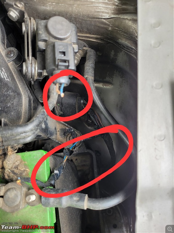

On a very different note, it can be a rat bite,
If it's a bite then it's not a major issue
We have a rapid in the family (8 years old / 77k driven / diesel) and this has happened to us couple of times, (engine + coil light) ,
Get the socket near battery area/ electricals checked from a mechanic he will be able to detect, refer image below

On a very different note, it can be a rat bite, if it's a bite then it's not a major issue
No Asoon. Not a rat bite (though always a worry )
