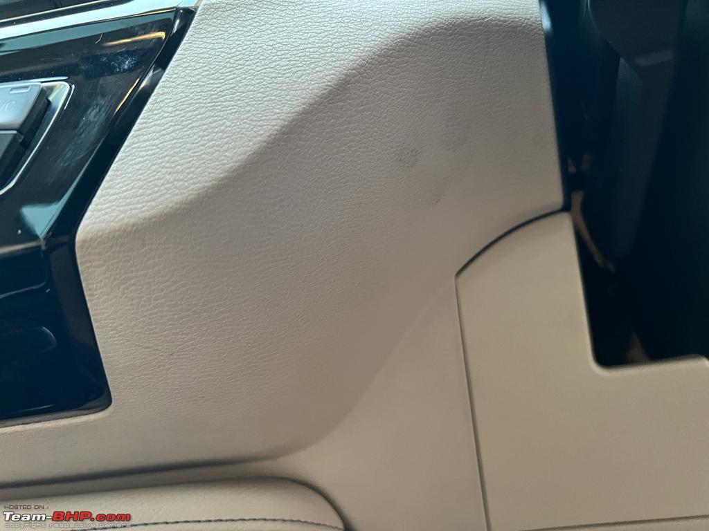

There were some issues with the sunroof so BMW agreed to replace the entire rack. However they wanted me to send the car to their Infinity Cars Turbhe Navi Mumbai workshop since they have their so called “Experts” placed there. I was not ok with that workshop knowing their history and personal experience but I had no other option. The car was returned to me after multiple delays and in absolute filthy condition. Mechanically also they botched up the entire replacement, the sunroof is not aligned, makes terrible noise. How do I sort this mess?
As you can see they don’t have any concept of wearing clean gloves while working with interior trims and parts
BMW dealer botched up sunroof replacement under warranty | Horrible quality of work-cf1236c0a4a142c392938333b25113c3.jpeg
The results

Their experts could not even get the basic alignment done properly
BMW dealer botched up sunroof replacement under warranty | Horrible quality of work-2d313ad3218644e8ae2a561a9da214b7.jpeg
Motor does not sound right and the one touch switch too does not work properly.
Blinds not installed properly and are touching the frame towards the end of their cycle.
